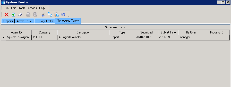

Our LIVE Database works fine…but when we use our Train or Pilot database all of our reports go straight to scheduled tasks?

@Rowley150, restart your Task Agent. It sometimes freezes and everything just queues up in Scheduled Tasks.

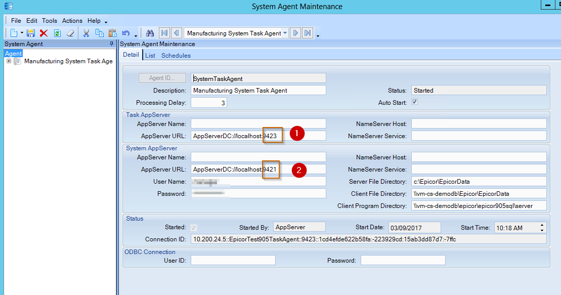

in the client for Pilot, navigate to System Management > Utilities > System Agent.
  • Confirm that the Task Appserver URL is pointing to 9423 (number 1 below).
  • Confirm that the System AppServer URL is using port 9421 (number 2 below).
  • Save your changes.
  • Restart the taskagent and processserver for Test.
In Training, Task port should be 9413 and System AppServer port is 9411.
NOTE: you may need to stop your production taskagent and processserver before you can save changes in the system agent in Pilot and Training.

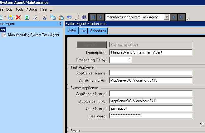

This is TRAINING:

it is 943x for pilot - my apologies. the 942x is for test.
can you take a screenshot of your entire system agent record? Is there a connection string on the bottom of either database that doesn’t work?

here is the TRAINING system agent…and no the manager p/w has not been changed.
Which login ID and password u have used for Production / Test in Task agent Configuration ? I think there should be only Manager ID and password. Please try with manager login, restart task agent and chek whether it make any difference.

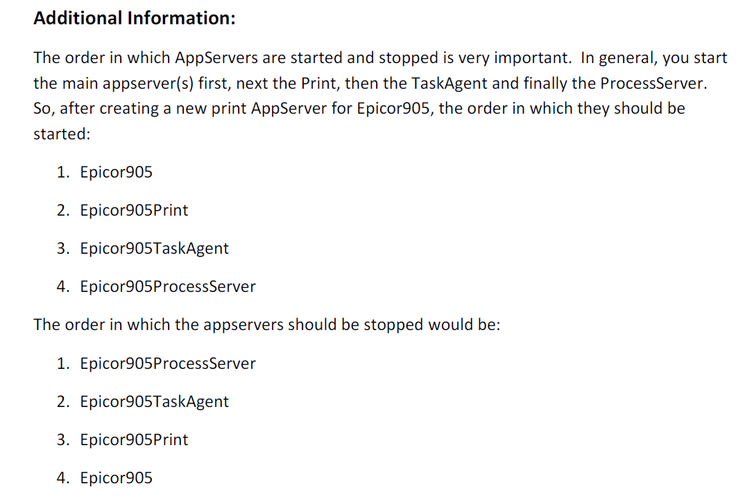

Additionally to the Task Agent settings and ports, you have to look at 2 other things:
  1. The AppServers start/stop sequence/order.

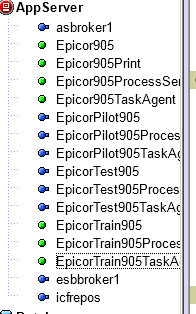

Log in to the OpenEdge Explorer
Click on your [ENVIRONMENT]TaskAgent (or Print) in case you have separate printing appserver.
Then click on “Log File Viewer of Broker” and “Log File Viewer of Servers”. In both cases, you should look for errors.
If everything is fine, you should see something like:
and
Hope that helps.

I went to open edge and on the EPICORTRAIN905TASKAGENT i clicked on the “log file viewer of broker” and “log file viewer of servers”…and both looked similar to yours above, …nothing jumping out with errors.

I have had that issue when my ports were wrong or not stopping and starting the APP servers in the correct sequence. Do you have one server or do you have 2 servers.

ok good news…i had an epicor consultant do a webex with me…it turns out somebody had disabled the user “printepicor”…and that is the user set in the system agent.
So, that is PILOT up and running again!
Agh…yes, that would get me in the beginning when I would restore Pilot for finance and disable everyone but forget to enable Print.
