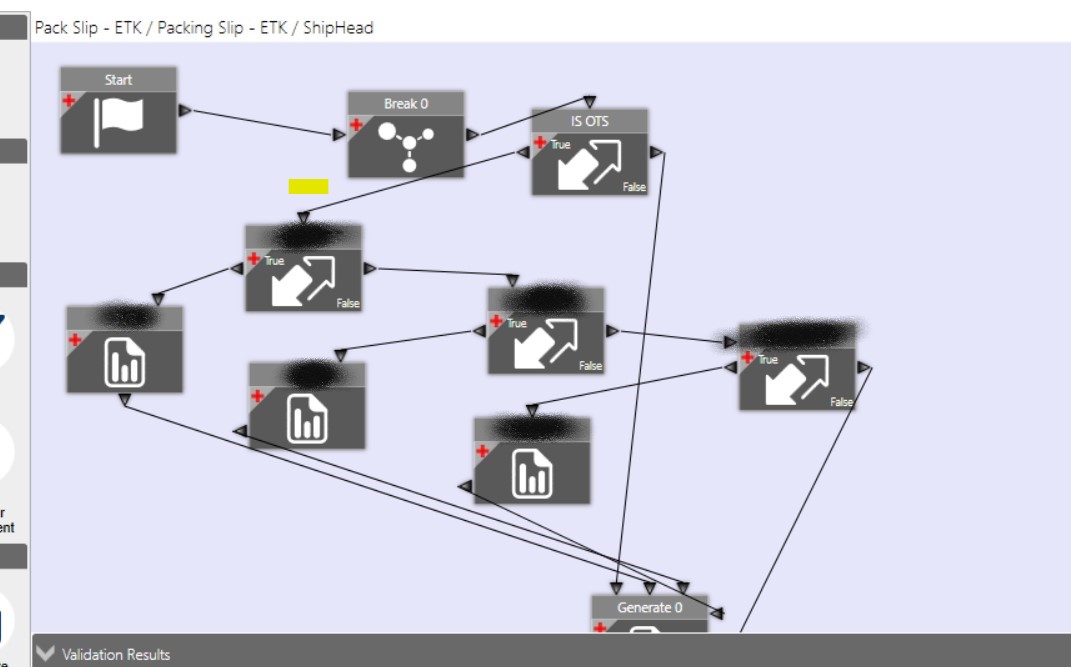

@knash since you already have the report styles created, you can create a routing rule that automatically selects the correct report style based on a condition.
add a routing rule, break on the pack number, add a condition to check for the customer number, if true then select the Alternate report style, then action is either print or email or whatever you need (test with preview).

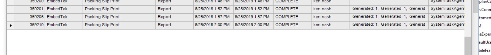

I updated so they are all using the same RDD. When I run print preview, nothing happens for the user.
task monitor show something is happening.
Anything I am missing that is jumping out at you?

generate is not good for you, that just creates the dataset. try preview.

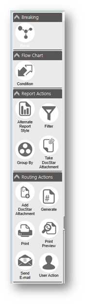

will this respect the action by the user then? if they click preview vs print?

found the user action widget. sorry I missed it right in front of my nose
