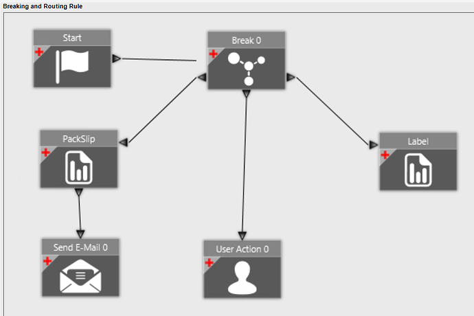

I would think you can do something like this, no? What are you breaking on?
@utaylor, this is exactly what I’m trying to accomplish. I am printing 1 pack at a time and breaking on Packnum. Should I be breaking on something else?
No that’s fine, so did you do the layout as seen above where the alternate report styles are the individual pack slip report and the individual shipping label?

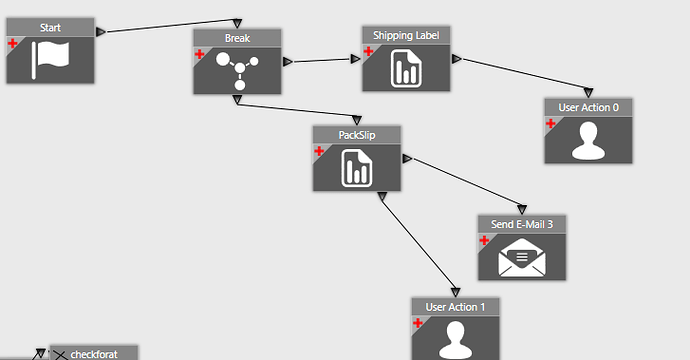

it’s working now based on your latest suggestion. However, it’s sending copies of the same packslip with an underscore on the other. i.e. 21735.pdf and 21735_2.pdf.
Here’s my scenario:
I print preview both Packing Slip and Label on the main report style.
PackNum is the Break and splits into the PackSlip and Label report style.
I get 2 attachments on the email. 21735.pdf and 21735_2.pdf
I also get 2 pdf previews of the packing slip and 2 pdf previews of the label.
I am thinking it’s triggering on the main report style as well as the other two.
That’s kinda wild, the only thing I would do differently is create two user action nodes, one for each report style.
another thing. If I preview only the packing slip, it works on the email side but it previews both the packslip and label. I even removed the report location on the main report style but no change. weird.
And if you print, it emails both?
Here’s one my option:
Packing Slip Only - email and user action works.
Shipping Labels only - user action works but it still emails me the packslip.
Both - user action works but it now emails me 2 (attachments) copies of the packslip.
