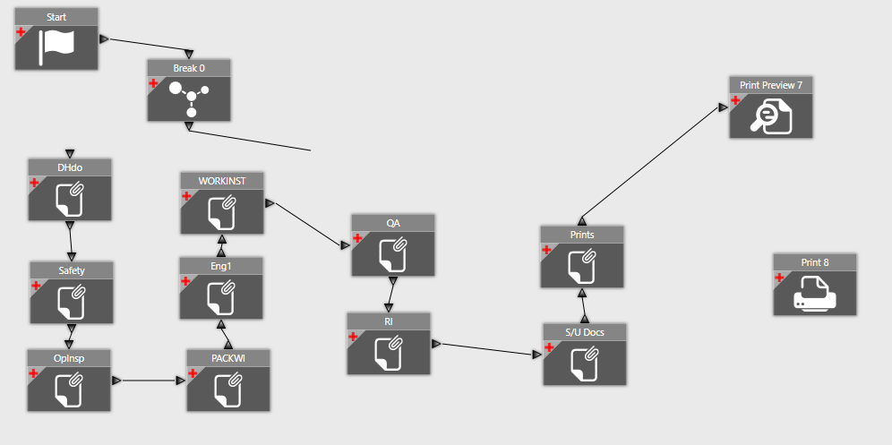

Update: I have the APR design working exactly how i want it with one exception. So when i go to print a job traveler it will print the traveler as well as all the attached documents that are in the specified document type in the breaking and routing directive. The exception is, I need all documents in all document types to print not just one specified type. Does anyone know how to do this in APR?
I have another update: Per Epicor, i have the APR flow setup correctly and it should be working…what is happening is whether i am in the client with classic or kinetic or on the browser, it will only print the job traveler and PDFs, no other file types like excel or word. Has anyone else seen this before? I am currently on version 2023.1.40. @MikeGross I know you are an expert of all things ECM, would you happen to have any insight?
I am not familiar with attachments that are not in ECM. But if you have ECM, you just add another Take ECM Attachment widget and specify the criteria for the attachments you want.
Disregard that the final step is going to print preview, that is just my work around for now, but this is what my set up is. All attachments are in ECM. It is only printing the attachments that are PDFs.
Do you have this set up to take the file extensions for the doc type? I generally add multiple ones for the doc type if I have different file types. So, one widget WORKINST that is PDF and a second widget for DOCX.

In the File Name Ends With in my screen shot. I don’t know if you can do a compound statement in it, so I just do multiple. Maybe someone else reading this knows if you can do a compound statement.
So for example, i edited the S/U Docs, which are always excel files, to say in the file name ending with field to .xlsx and printed and only PDFs printed out again.
Did you select the correct attachment table and doc type?
Also, might need a * in front of it. Have not done one in a while and can’t remember.
Yes, all of the attachments are on the jobhead table. We dont place attachments per operation or assembly or anything like that. I tried with the wildcard in front with no success either.

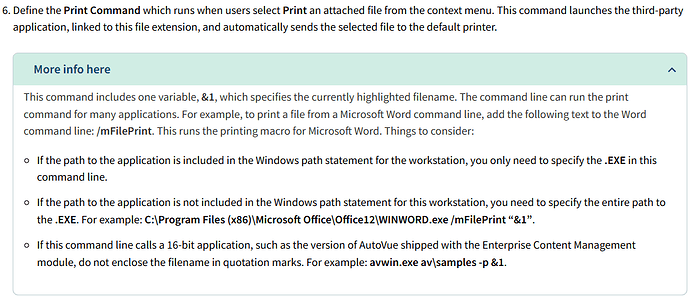

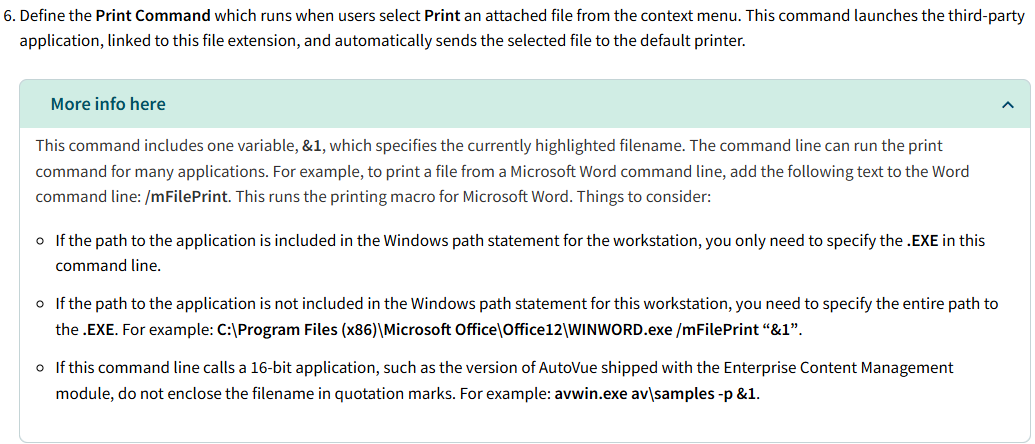

Last thing I can think of is whether or not you have set up the Document Associations. Not even sure if that is required, but the system may not know how to process the file types.
From help.
@MikeGross , @gpayne , is this necessary?

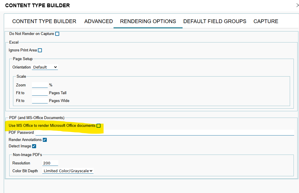

I’ll do a little research, but I’m thinking that you’ll need to set up the Content Type in ECM with Rendering Options - so when an XLSX comes in, it’ll get converted to PDF using the ECM Client rendering tools. This requires that MS Office be installed on the same server the client runs on. For a deadhead client process, you’ll need a single-user license of Office, to be compliant.
This way all the job attachments are ultimately PDF when stored and retrieved for printing. This also solves the problem of potentially changing the XLSX after the job has been processed (job data integrity). You could still submit a new XLSX, but it’ll show as a version change, indicating some change has been made. We have a similar issue with our part drawings, so we force them to exist ONLY in AutoCAD Vault and be viewed on MES stations by a link associated with the job.
Is this what you are talking about?
Disregard. That is checked for all of my content types.
