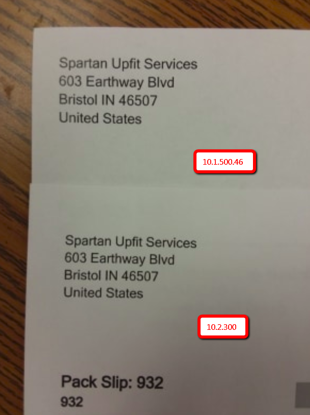

@Mark_Wonsil @Rich @josecgomez I am not even just talking about MICR - lets put MICR aside, lets print a basic SSRS Packing Slip to a normal Paper Printer.
10.1.500 vs 10.2.300
Little hard to notice on the picture, much more visual in person… But 10.1.500 has a smaller margin and the font is larger overall by .2pt – the 10.2.300 version has a larger margin and is “Scaled to Fit” causing other issues, but here is the exact same RDL.

Yes, all reports have this differente between 10.1 v 10.2. There is no difference between RDLs when compared via WinMerge
Quote, ARForm, Out of the Box SSRS, Custom SSRS… I also have 3 other servers, same issue. So I think it is a Epicor Architecture Change, but id like to know how it works or if we can disable it.

I’ve tested this on 6 computers, 2 different servers, 2 different Corporations, atleast 4 printers – same exhibiting the problem. As far as I am concerned it isnt an isolated change. It may literally be a code change in the Task Agent how it queues Reports to SSRS… I’ll start comparing my SSRS Databases see if it adds additional parameters in the XMLs it sends to the ReportServer. I also have 10.1.500.46 and 10.2.300.13 so I can print both at the same time, to the same printer, with the same Style etc…
I am not calling this a bug, its a change, probably for the greater good - it would just help to understand the logic. :slight_smile: and maybe some docs on it. Because now when you have margins in SSRS dont expect it to come out the way you think. If you say margin 0.25 – it will be 0.35 or 0.45. (If your print preview, you might not notice it because Adobe does whatever Adobe does) but if you Print direct to a Client Printer, you might notice it.
The only way I got the behavior to work like in 10.1 was to set the margins to 0, 0, 0, 0.
