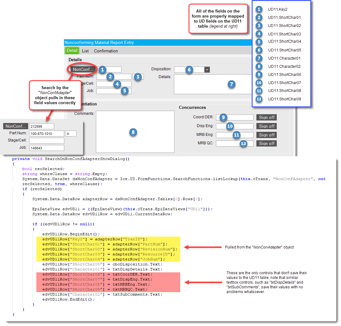

I’m working on a UD customization (using UD11) where the intent is to allow a user to search for a specific Non-Conformance record and return a handful of pertinent values from the NonConf adapter. The user will then continue with the task of entering key data points that illustrate the agreed-upon disposition and the Engineering substantiation for that disposition along with sign-offs by each of the engineers involved in the process.
In testing, the Non-Conformance adapter search method pulls back the correct data and populates the intended fields with no problems. After adding values to the other fields, I save the record. However, a peek into the UD11 table shows that all values are saved except for anything that gets populated into the “sign-off” textbox controls. These textbox controls are no different than the others that have been configured on the form with their EpiBindings to UD11 well-defined. The textboxes that do not save are all set to “ShortChar” fields that have a 50-character limit (my name being used in this test only has 12 characters).
Here is the C# for the Non-Conformance adapter search method:
Can anyone detect what I might be missing, or perhaps if my approach to this is not the way I should be doing it? Admittedly, I’ve made quite a few assumptions during this particular task relating to the idea that I could save search adapter values along with usual data value inputs within the same data view structure. However, if this is not so - then why would the other values, such as “cboDisposition”, “txtDispDetails”, and “txtSubComments” process through this method without error?
What could I be overlooking here?

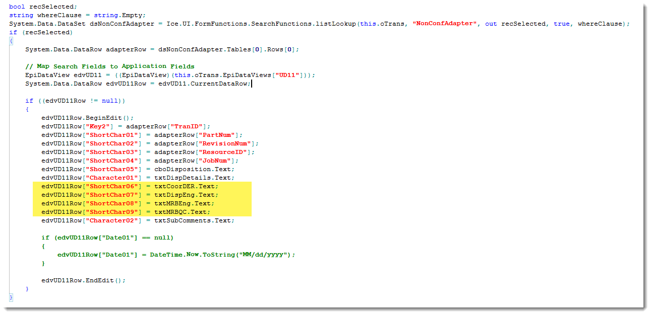

The textboxes are bound in the data view shown below as “edvUD11” - BUT - they are mapped during the search function call on the “NonConfAdapter”. I have a hunch that those data view bindings are being defined prematurely in the wrong spot:
Yet - the other textbox and combo-box controls seem to work just fine.
