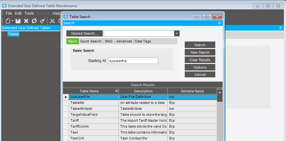

If you extend Ice.SysUserFile and add your column, you should be able to then see it in the customization. You will need to move your data also.
That sounds easy enough, heh. I assume there is a proper way to go about that and I shouldn’t just open up Ice.SysUserFile and add a new column to it.
Just use extended table maintenance and select the table and then add your column. You will need to regenerate your data model.

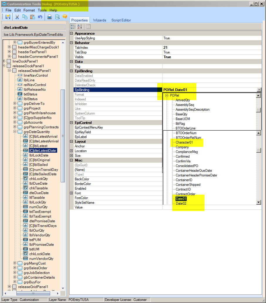

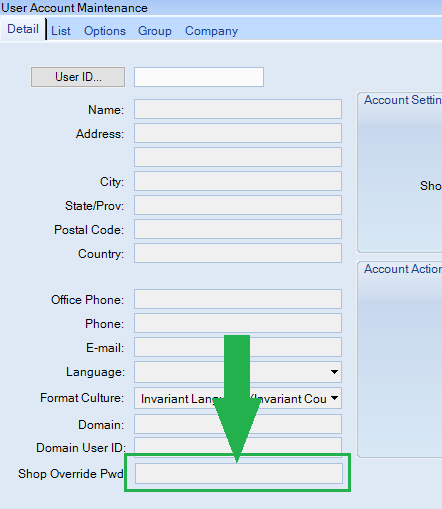

Hi Jason,
I agree with John that the field “should” be in the user table and carried into customization automagically like it did for my PO entry customization screenshots below:
Nancy
Nancy, John, Dan,
This is what I have in UD Table Maintenance:
I assume that I am supposed to input some value(s) into the fields that are marked with the red box…My guess would be the values should be: Erp UserFile_UD Character01 …but I am not too sure.

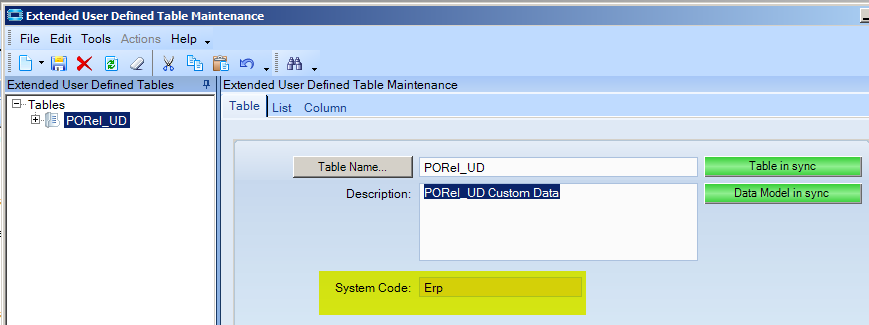

Hi Jason,
I did not have to complete any “like” field to make it available to the customization. See below. I suspect the “erp” type vs “ice” type may be causing problem with not having your field available in customization.
Nancy

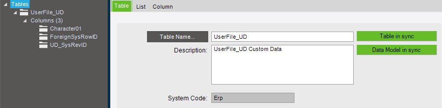

Nancy,
I looked at the Erp.UserFile_UD in the UD Table Maintenance, and it has Character01 in there. Here are the screens for it:
That was in there automatically from the conversion (which is to be expected, I would think). That is why I am so confused as to why it is an available selection for the EpiBinding on that control in the customization. I can’t seem to figure out of I missed a step somewhere with having to ‘approve’ that UD during my post-migration tasks, or if it is something bigger and I am going to have to reach out to Epicor’s tech support.

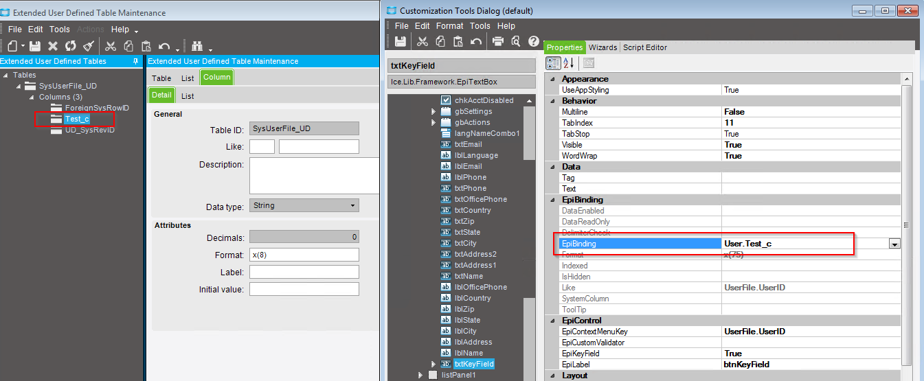

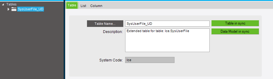

I am pretty sure UD creation in Erp.SysUserFile is a bug. If you create the Ice.SysUSerFile_UD it works just fine

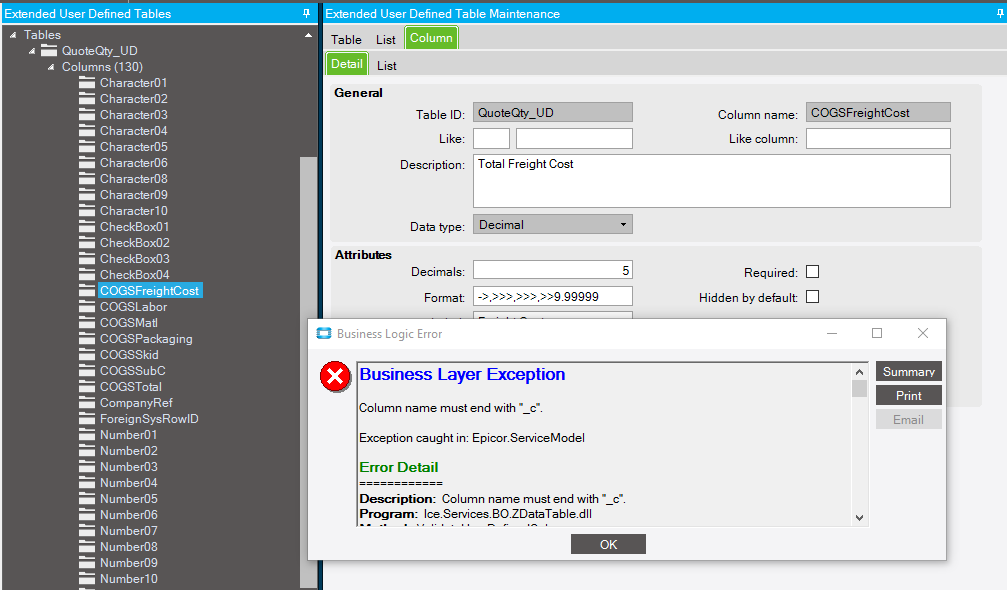

This still happens in 10.1.500.31 – I Migrated over about 100+ Fields that I had in E9 and I can’t modify the FieldScale, Format, Description etc…
Also there is no Method Directive for:
Program: Ice.Services.BO.ZDataTable.dll
Method: ValidateUserDefinedColumn
I was hoping to override the Base.
Maybe @Bart_Elia can expose the ValidateUserDefinedColumn Method in Method Directives in the future and we can override it. It doesn’t make sense for me to recreate 431 UD Columns with a _c which already are used in Customizations, Reports, Labels, RDDs…
I am confused. These were made in E9 and not migrated?
They were made in E9 and they migrated to E10… which is good - but I can’t change anything anymore on them… in 400 i could change the FieldFormat…
I want to continue to use my legacy UD Columns that all 300+ from E9 regardless of _c =)
Yea looks like a bug - Ticket Please.
As a workaround, have you tried locking down the custom fields attributes in Extended Properties Maintenance?
@hkeric.wci Update - It was already fixed: SCR 201972 in 10.2
