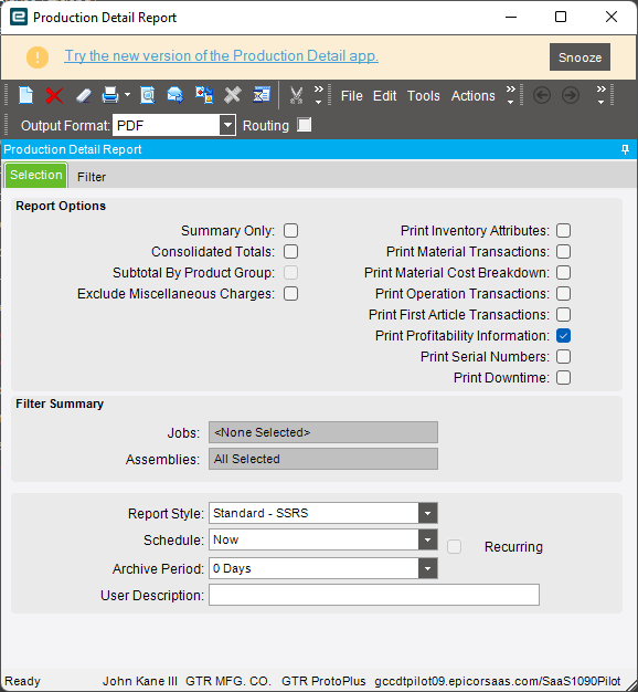

When I run a production detail report on a job, how can I also capture all sub assemblies and materials in that report? Seems when I run it now it’s just tallying the top level job but none of the subs
What options are you using when you run it?
Actually looking at your list, I don’t have “print profitability information” option on mine, I am using the Kinetic screen if that makes a difference?
I usually have the material cost breakdown, operation transactions selected.

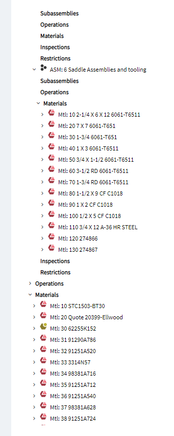

What are the subassemblies set as on your routings? Pull as Assembly or Plan as Assembly?
Ahh… ok so when I clicked “template” it brought the sub-assembly material in. Interesting. I guess the “template” box is Pull as assembly/plan as assembly?
Template? The check box on the Job header?
