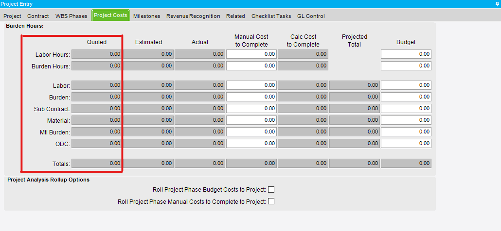

Hi :pray:
I am trying to make the values appear here (Project Entry > Project Costs), but the values are still 0. And I want to know where the values that will appear here are defined in Epicor, or if there is a way to make the values appear.
Ps. I “Build Project Analysis” already.
Help me please. Thank you so much :face_holding_back_tears: :pray:

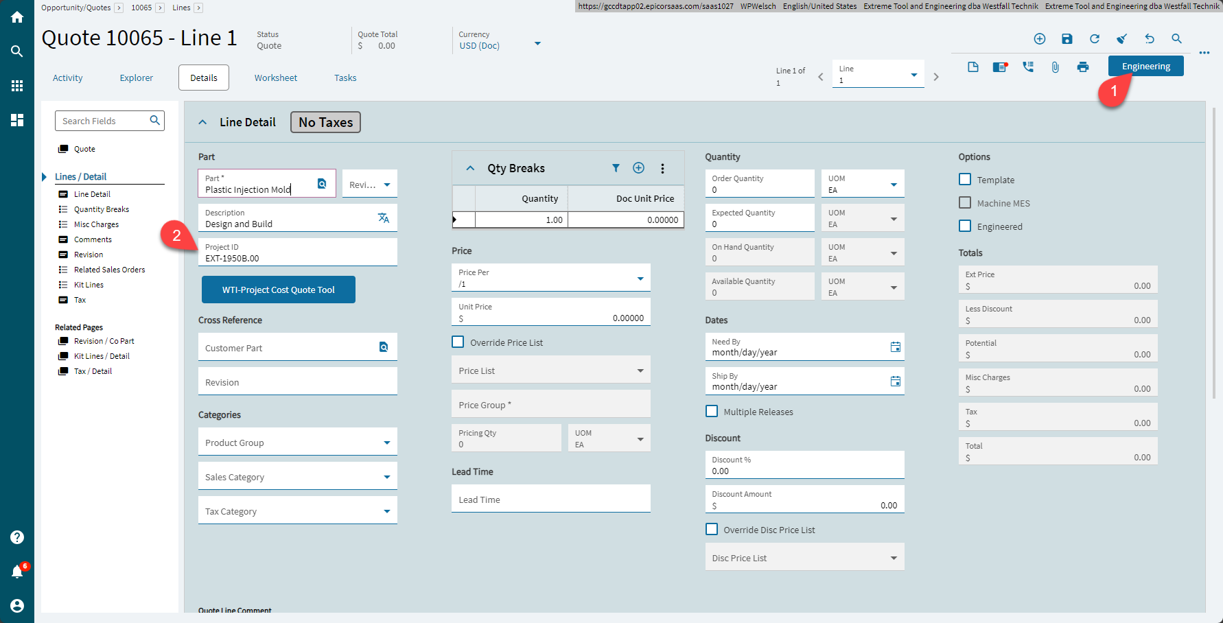

There is a Project field on the Quote Entry - Line tab. In the classic UI, it’s on the right side, under the Quantities box. We don’t use it, but it’s the same on the Order Entry screen so I assume it’s what you’re looking for.
Hi Minnie,

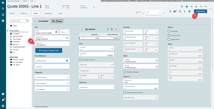

Mike is right. If you engineer your quote lines, adding labor, subcontract, and material requirements, then add a project ID to the quote line, you will see the costs on the Project Costs tab/page after you build project analysis.
