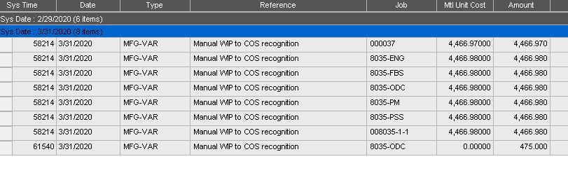

I am seeing a group of weird transaction on the transaction list of the Project Management Revenue Recognition screen. This project has not incurred any actual material costs yet, it only has estimated mtl costs. For some reason a process has caused a Mfg-Var transaction to hit every Phase Job on this Project with the same material costs with a reference of Manual Wip to COS recognition.
None of the Phase Jobs have estimated or actual costs. No one manually recognized any costs for this project yet, so I dont know where the Material Cost dollars came from nor why they show a Mfg-Var transaction blown down to every phase job even though none of those jobs have any type of mtl costs.

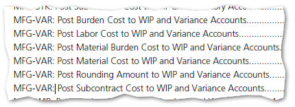

Has any labor been applied to them? From the Posting Engine Tech Ref:
MFG-VAR: Post Labor Cost to WIP and Variance Accounts
Executed for MFG-VAR transactions. Posts Labor Cost to WIP and Variance Accounts. Debit and Credit Accounts depend on the sign of the Labor Cost amount.
In fact, there are several things that can create the MFG-VAR, and not all are materials related.

All Project Phase jobs for the same Project. One is a MFG Job with only estimated MTL cost. No other job has time or material. There is no labor on any of these jobs.
The problem isn’t necessarily the MFG-Var transaction, it is this: Why is the manual Epicor Revenue Recognition process posting the same material costs to every job on that project even though only one has any costs whatsoever on it.
The fact that the first 7 lines have the same exact systime, indicates they were all created at once. Are there any trans that “undo” those? Like if someone did something on 3/31 (which created those trans), and then “undid” them on 4/1.
Change the GroupBy from Sysdate to Job, and see if there are offsetting trans per job.

These transactions coincide with a Manual recognition of a material cost transaction done in the Revenue Recognition screen for this Project. No Actual material receipt or issue transactions at the job level have been done for this project yet. We recognize a percentage of material costs when we bill the first milestone even though we have no taken on any actual material costs at he time.
