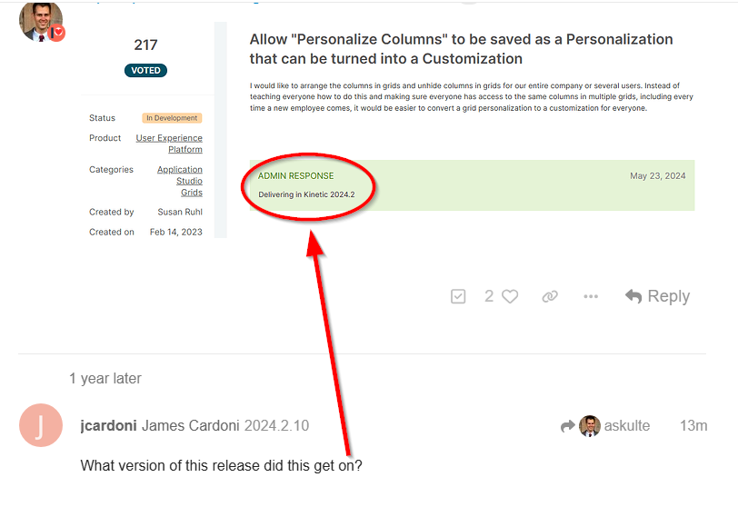

https://epicor-manufacturing.ideas.aha.io/ideas/KIN-I-3210
What version of this release did this get on?
Look up… it was in the previous post. We put the release were we added a feature into the admin comments (at least that is our current practice that we attempt to do).
So it was in the 2024.2.0 release or in one of the versions later? I asked because we’re on 2024.2.10 and saving column personalization to deploy as a layer isnt very obvious if its there.
