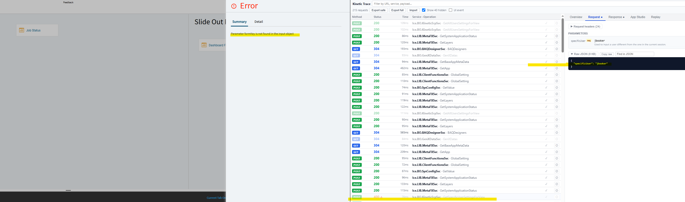

EDIT: FWIW, this is caused by the fact that my app is a dashboard created from wizard. the request for user layers is not passing my app name it’s passing Ice.UIDbd.Template.
I have no idea whether this affects all wizard dashboards or just this one.

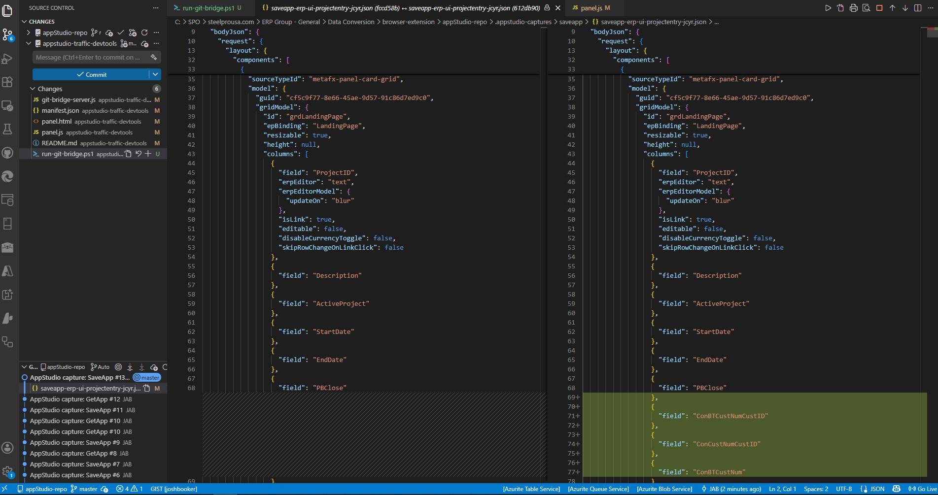

Looks like promote is indeed merging grid column personalizations into the current layer rather than creating a new layer like merge layers does.
This is the diff from SaveApp > Promote > SaveApp
This is weird and definitely broken. can repro on Job Status Base in edu as well.

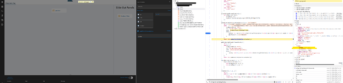

stack: onPromote > findKineticGridLayouts > getSpecificUserSettingsForViewActivity
> this.viewService.getViewValue().Layout.namespace
< undefined
