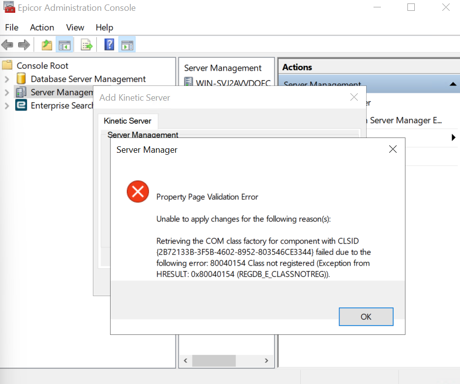

Hi can somebody help me in resolving this error please, I am trying to add a New Kinetic Sever but this error is coming up.
10.2.700 perhaps… I know there was a additional install that was required if you went and added a later version of Kinetic on an app server that already had 10.2.700 installed.
Hi Hally, what was that additional install?
You need to get the RL102700ACExtensions
You will need to login to Epicweb to be able to download it.
You only need to install this if you are running a later version install on a server that already has 10.2.700 installed on it. If I recall what would happen if you tried to add a new server for 10.2.700 it would not work, but other releases did. This may not be your problem, but thought it worth a mention.
