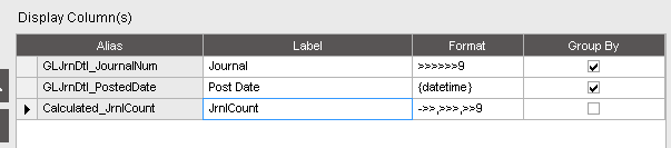

I made a BAQ of just the GLJrnDtl table, with the fields:
This should have unique values in the Jrnl Num row as all journal lines post “at the same time”, and they are grouped by the PostedDate field. But as you can see in the pict below, there are two distinct rows for Journal Num’s 1033 and 1035. Even though they show the “same” values for PostedDate.
Changing the format of the PostedDate row from {datetime} to {datefulltime}, yeilds the issue:
A time diff of just 17 milliseconds and those records no longer group together.
