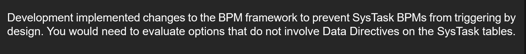

Unfortunately this is now “as designed” according to Epicor, Data Directives will no longer trigger from SysTask starting in 2024.1 (worked back in 2023.2). If you want put in a ticket, maybe when they get enough they will consider adding it back. Response from support is below (I asked yesterday about this no longer working). Why they would take away this functionality is beyond me, maybe @Rich or @timshuwy can find out and/or let us know

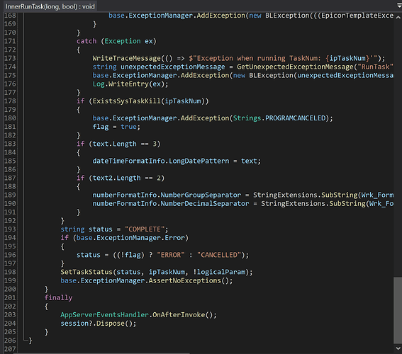

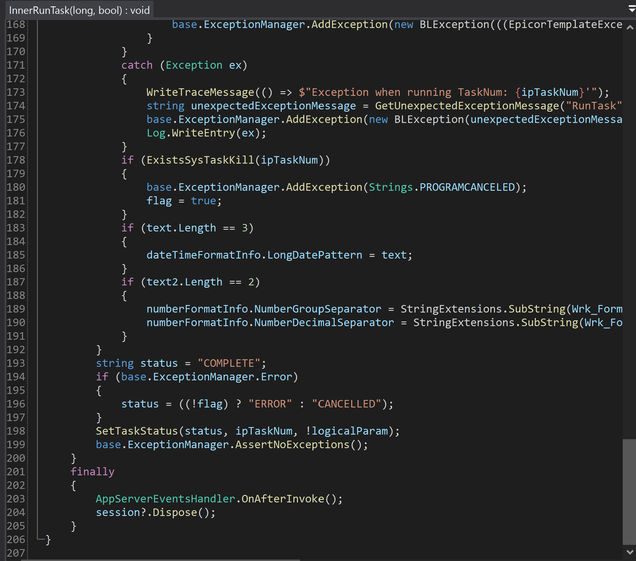

This one does work, only for completed tasks though. If the task errors out the post processing is not reached
The problem is with line 199, throws the error so no post proc to use the SysTaskNum to check what the status ended up being. I guess you could log each SysTaskNum that you would want to monitor into a UD table (pre proc) then have a scheduled function checking the status and clearing the UD table records every min that dont have a status of pending or active, but question still is why do we have to jump through hoops now to do this when it worked fine until now using DD’s. Also might be other method directives to monitor, haven’t dug into it that much yet

I believe that the DD not running on the SysTask table was introduced by prep work being done in order to change the way Reports and Tasks run. We need to investigate further but likely the capability will be restored.
