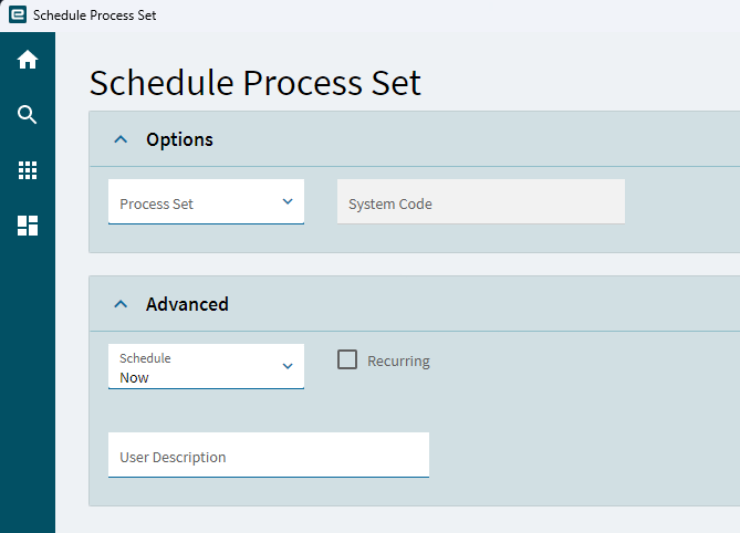

This is a good solution when everything runs correctly. Process Sets lack the ability to run one task if the previous task was sucessful and another (or none) if it errored.
They could still schedule a process set for Now.
How could they specify the parts for MRP to run on? They are updating the process filter in the Process MRP form a few parts as needed. They aren’t doing a full MRP run throughout the day.
