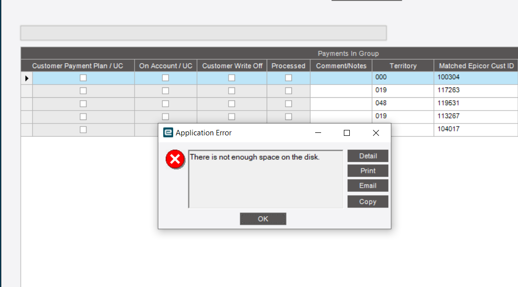

Turns out the Epicor client doesn’t automatically clean those Trace Files. This morning one of our users was getting a weird error in Epicor

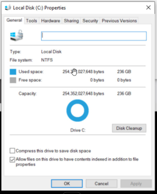

After much troubleshooting we remoted into her computer to see her C: drive was 100% full
HardDrive Full:

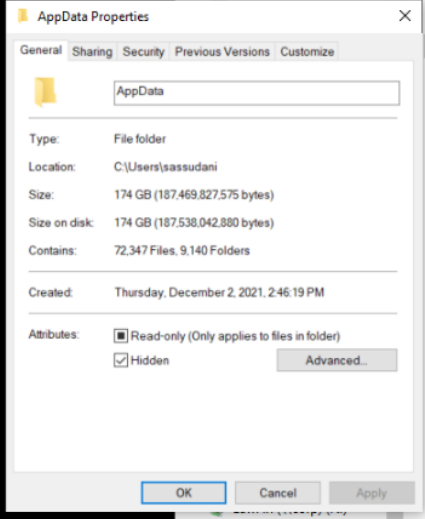

That’s right she had 172GB worth of Traces in her hard drive :man_facepalming:
Found a few more

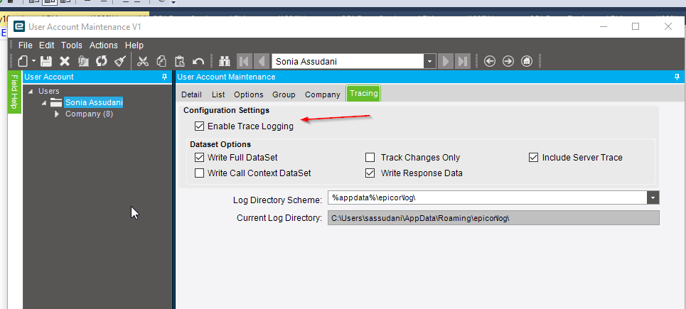

SELECT * FROM ice.UserTracing
WHERE DataTrace=1
