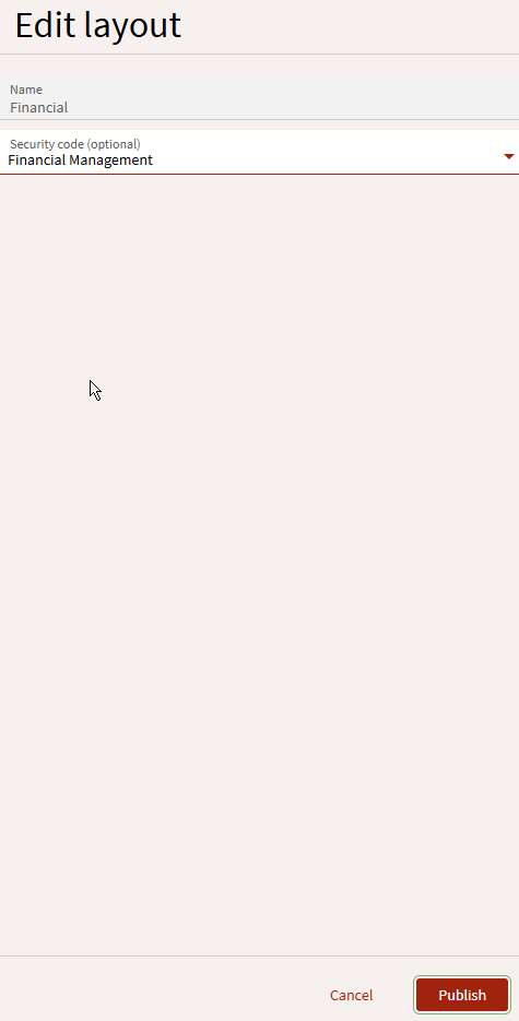

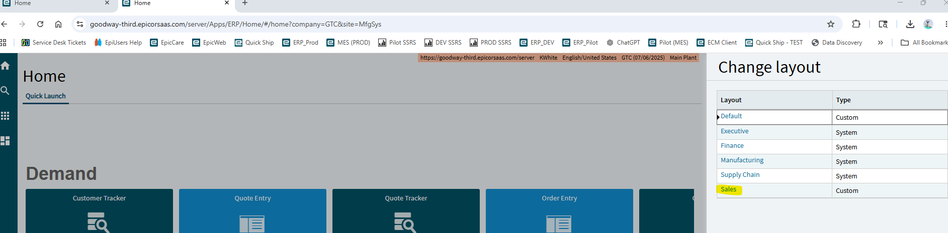

Did you try these steps, click overflow, click Layout Management:
and then pick Sales from the list which brings this window up:
And then click Publish.
I’ve got security populated for who can see it, leave that blank if you want everyone to see it.
Once complete, I would recommend logging out and back in on whichever user you want to see it. Click the overflow and see if Sales is now available to them.
