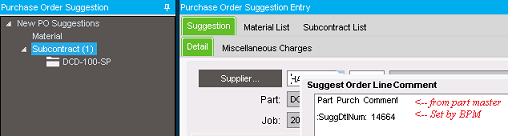

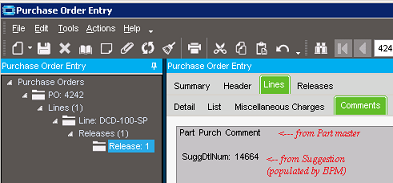

When I test generating suggestions after creating a new job with the subcontract op/part
comment came thru OK (note I also have a BPM appends the suggestion number to the comment).

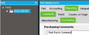

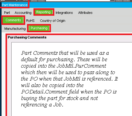

Part master –

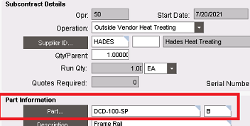

Job Subcontract –
PO Suggestion –
PO Line –
