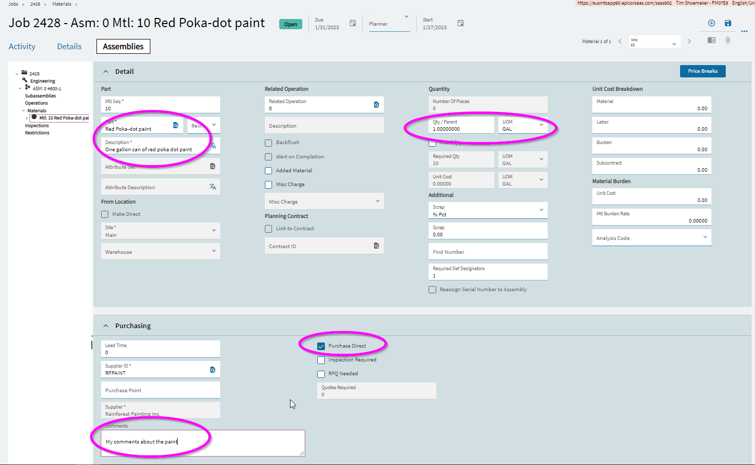

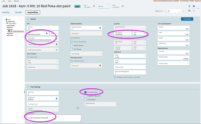

  1. in the JOB, you add the material to the job. if the part number doesn’t exist, you can also mark it as make direct or purchase direct. if purchased, you can even specify the supplier and any additional comments
  2. run “Generate Suggestions” in the purchasing module
  3. the buyer should then use the “New PO Suggestions” process, you will see a suggestion to purchase the item. at this point you select the line, and choose to Generate POs. This will then create a new PO for you with all teh details, including the comments you entered on the job.
Requisition entry works well for this as well. You can reference a job # on the requisition line. When you send the req to purchasing it auto adds the part to the job and *creates the PO suggestion at the same time.
*suggestion is created without needing to Generate Suggestions

Who tells the buyer what to buy? how are they telling the buyer… my thought is that they could change their mechanism to tell the buyer what to buy into using the JOB instead of the current process. OR a requisition like @zwilli526 suggested.
I think you are going to go through a lot of work/customization to get it to automatically work by pushing from a PO since that is sort of backwards.
