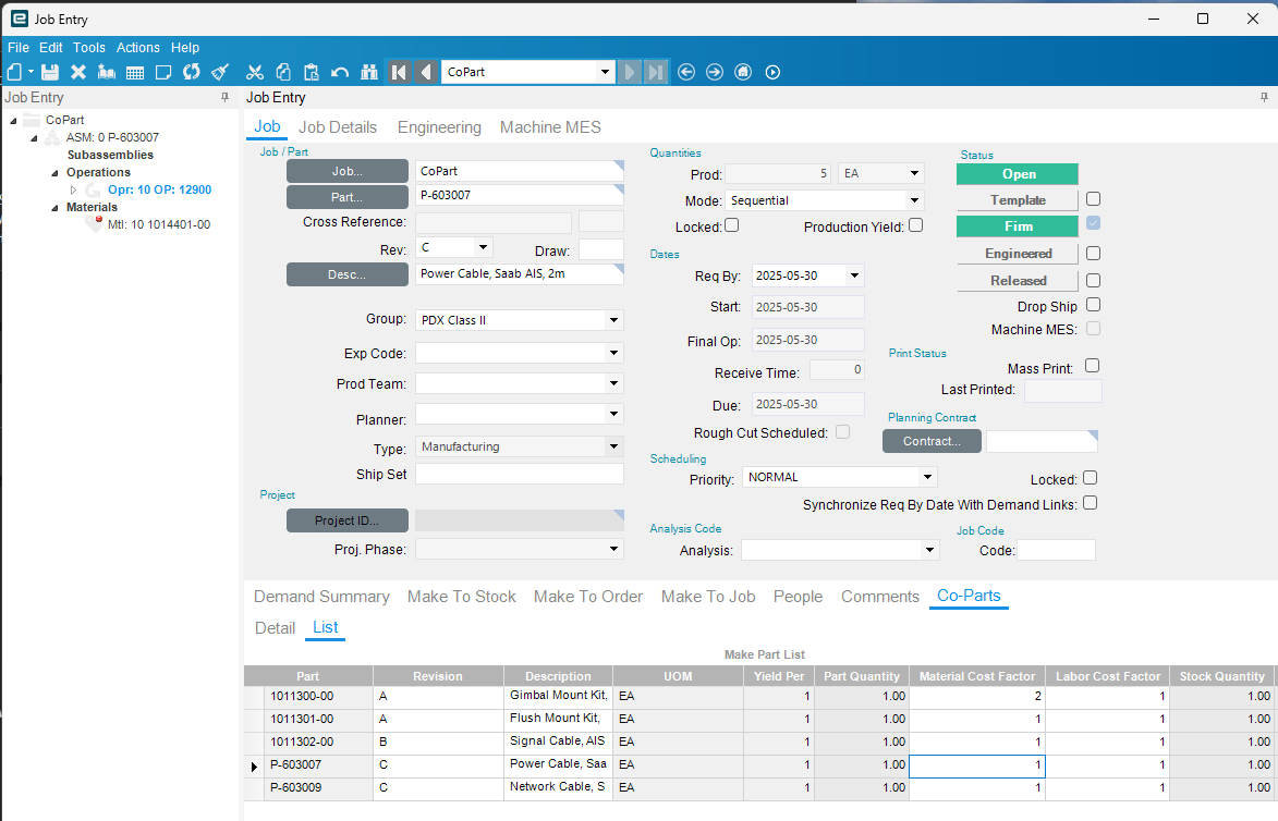

Essentially, the carton (part A) is purchased. Then, all your parts that come in the carton are manufactured (B, C, D, E, etc). You pick one of them to structure a method to. You set the concurrency field to Concurrent on the Revision. Then you structure the method with one operation and one material (the carton). Then go to the CoParts tab on the revision and list out the different other parts from the carton. Make sure to set the quantities per carton properly. For instance, if there are two of one part for every one of another indicate that by putting 2 in the Yield Per. Costing is tricky. I haven’t worked that all out yet but essentially you just pick the cheapest cost and leave it at 1 and then assign the cost of the others as a ratio of the cost per component vs. the lowest cost item.
Part B = $1 = 1 Cost Factor
Part C = $2 = 2 Cost Factor
Part D = $5 = 5 Cost Factor
You would schedule/release the job as you receive them in and look to store them as their individual parts, rather than the carton. To complete the job, you would open up Report Quantity for the operation and then you have to go to the Co-Parts tab and report the quantity for each co-part. Then You complete it and you will see transactions that consume the 1 material and add proper quantity for each of the co-parts on hand. Costs should work out as a fraction of the whole carton based on the cost factors entered.

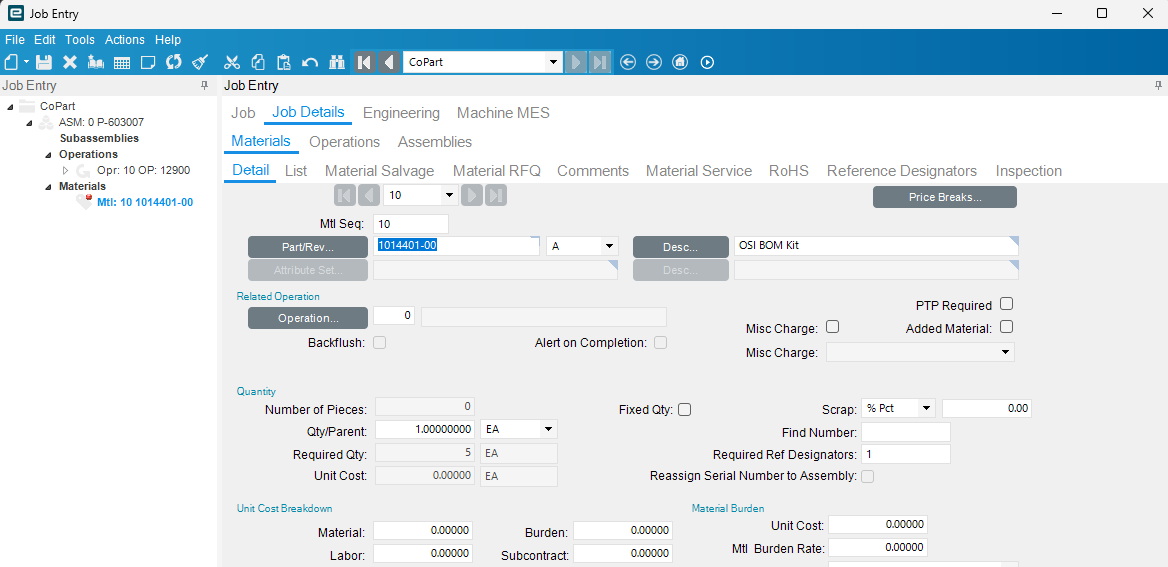

I am using Co-Part to deal with purchasing in Kits as well, when I set it up, it is telling me that I need 5qty of the Kit, as suppose to 1.
I think Epicor got the 5, due to my Co-Part having 5 PNs (each with 1qty), not sure how to fix this…

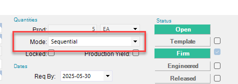

Your job mode is Sequential. It needs to be Concurrent. You would set that on the Revision tab in the Part Maintenance screen. You might be able to just change it there on the job and see if it recalculates.
awesome, got it now. Thank you!!
