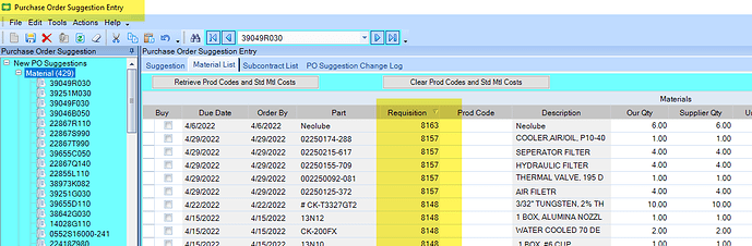

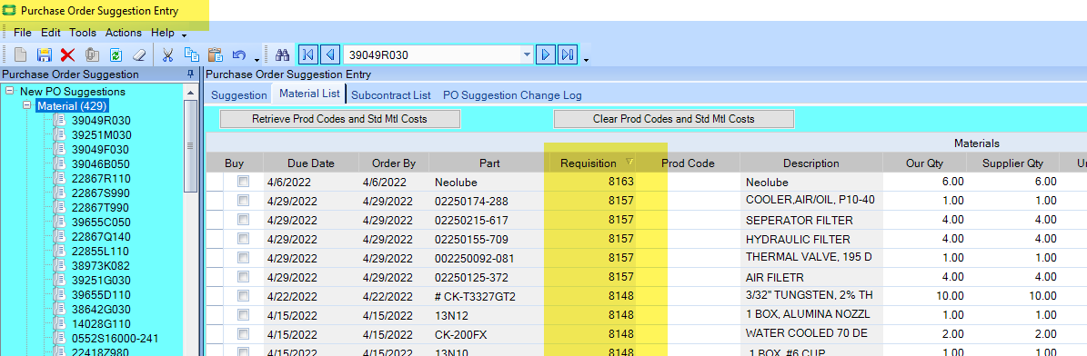

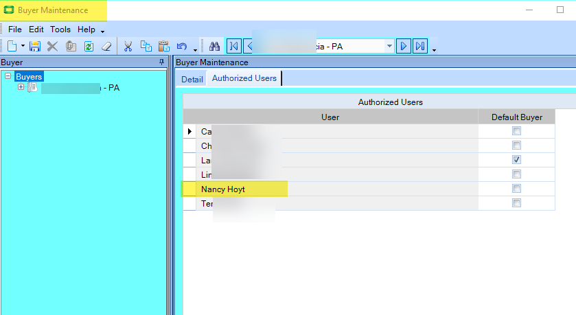

The Requisition should be in New PO suggestions accessible directly from menu or from Buyer workbench. Use binoculars and bring in all suggestions. The buyer must be an authorized one to see the suggestion. To view a buyer’s suggestion, you need to be setup as an authorized user for that buyer in buyer maintenance. In the grid view of the material list of PO suggestions, make sure you can see Requisition number field per below. Click the suggestion for buy and Actions / Generate Purchase orders and it’s now a PO.

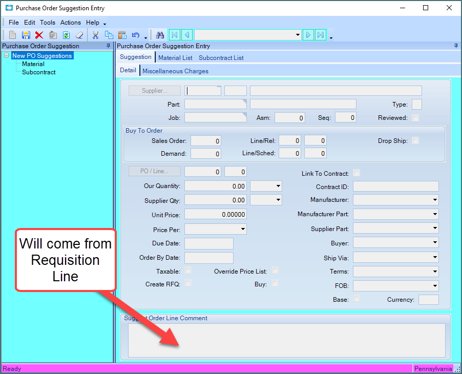

We have buyer workbench under Material Management / Supplier relationship management. I prefer just going to New PO suggestions personally, but our buyers like this workbench. Our buyers need to regularly open and review new PO suggestions because we run MRP nightly w generation of suggestions. For solely processing these reqs however, you probably could put an BPM for an auto email to the buyer on the dispatch of the requisition “send to purchasing” and then buyer would know to go to New PO suggestions to process on the basis of getting the auto email. One other thing we’ve found useful with Req is to enter Line comments on the Req to communicate with the buyer. When they see the New PO suggestion, it shows at the bottom per below.
