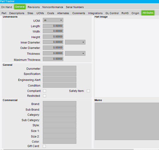

Well I didn’t look in part.
There is a Brand Field (Part.CommercialBrand) in the part tracker. Under General tab > Attributes Tab > Commercial section. Think this is the solution.
Any ideas or advice welcome.

Prior to attributes we added a field with a dropdown that linked to the manufacturer table.

We still use it. The manufacturer table has the distributers in order of preference and I did not want to rebuild that.

You can also track supplier part number, Manufacturer and Manufacturer Part on the supplier price lists. It is already built in there. Qualified Manufacturer also lets you attach a manufacturer and part number to a part record.
