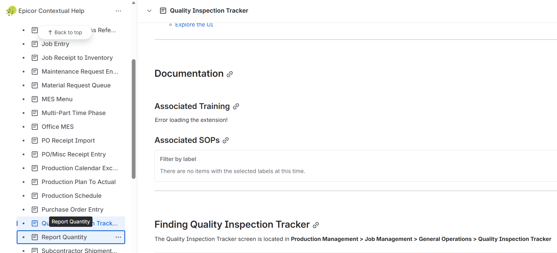

I found an old post that mentioned Quality Inspection Tracker for this exercise. However, setup team says that option does not exist. See below - If not this method, then how?
I don’t see that on my menu either. I wonder if its part of the Advanced Quality module (which we do not have)?
I have the Advance Quality and cannot find.
We don’t do Inspections here, so I can’t really be sure with data, but is it possible it’s under Inspection Data Tracker?
Production->Quality->General Operations

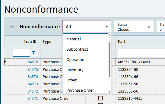

That only shows nonconform. I want to see all previous inspections.
That does show all previous inspections. Technically anything that goes through Inspection Processing is a nonconformance, even PO Receipts.
If you’re in Kinetic, choose the Closed option in the Status dropdown to see past inspections and then filter further on which inspections (ops, material, inventory, PO, etc.) that you want to see.
