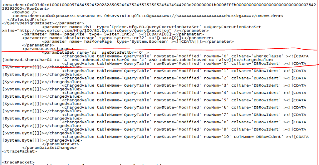

I am trying to read the where clause to do some calculations in the post processing of getlist in a baq. I see the where clause in the paramDataSet in the trace file, but can’t figure out how to access that information.
