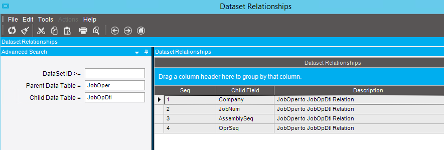

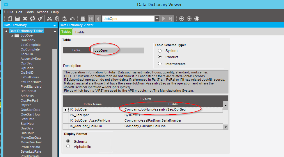

Is there documentation there that says what the entire index is? I know that company should be joined with company, but are there others that are specific to tables?
Check out DataSet Relationships:
also see Data Dictionary Viewer
oh, look at that menu hiding in all of those folders. No wonder I never noticed it.
