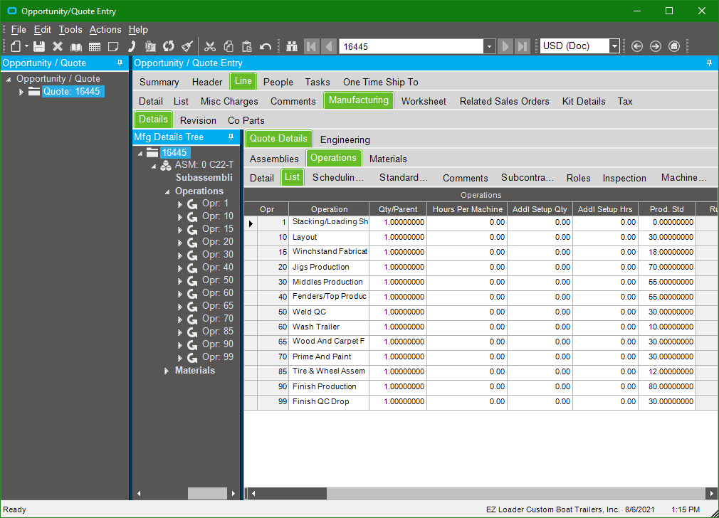

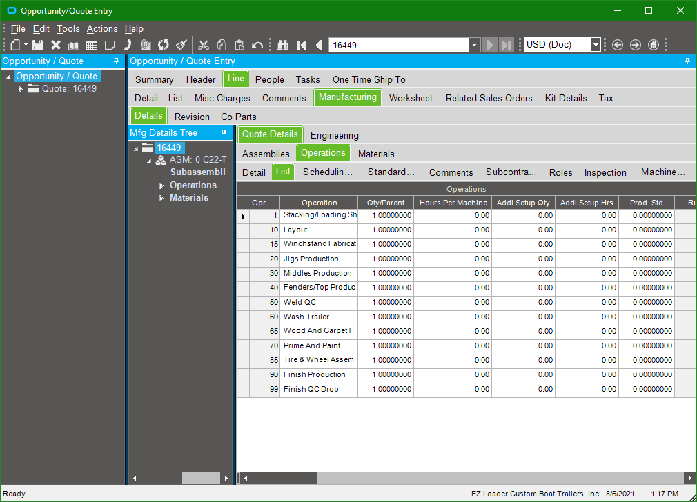

Anyone have any ideas on this? To be specific, I have a configured part and all the op times are different and come from a UD table. Upon duplication of the quote for these configured part(s), the duplicated quote does not retain the operation time from the original. Would this be a “BUG” or an intended feature?

Now look at the Prod Std column of the duplicated quote here:

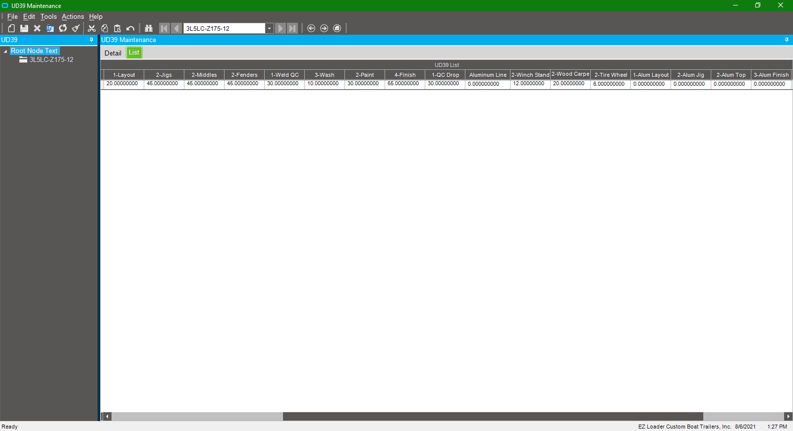

What is coming from the UD table?
Sample Data

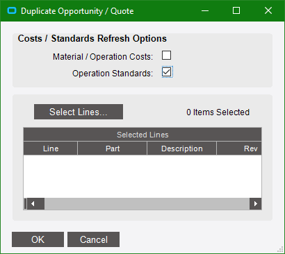

Ok after going through this more and getting a little more information, I found out they were checking the Operation Standards causing it to ignore the configuration and instead pull from the Operations Standards Master File (per help). This is what was zeroing the configuration time values as these are all calculated individually and specifically per trailer model configuration selection.
( Bad checkbox below for our configured product :frowning: )
