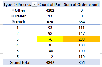

What I found today is that I have a kind of unsolvable problem. Basically, our sales backlog is so lopsided to two part numbers that using multiple process in MRP has a really finite limit of getting any more efficient.
Here’s the situation.
Roughly 100% of the revenue in the main plant comes from engineer-to-order, make-to-order trucks. An order might have dozens of lines for the same exact truck, but they are all quantity of 1 and make direct. (It’s so we can gauge the margins and schedule things. And each is tied to its own Project and always will be.)
So I ran MRP on 6 processes and took the MRP logs, all 890,000 rows of them, and made me a pivot table. Process 3 gets hammered. It actually has the fewest level-zero parts, but by a longshot it has the most make-direct order lines (and thus unfirm jobs) - by a factor of 2 or 3.
FYI, I did use Recalculate Part Low Level Code (aka conversion 580) ahead of time. All the truck part numbers are level zero.
When MRP runs multiple processes, all processes have to finish level zero before anyone can move to level 1. Makes sense, after all.
But while five processes have been done for hours, Process 3 is slogging away.

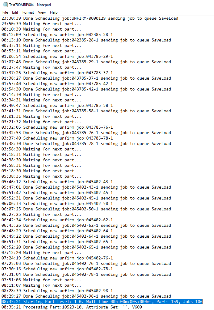

And the others are “Waiting for next part…” Here’s the log of Process 4:
Expand for pic of log
Almost 8 hours of sitting around until Process 3 is done with level 0-0.

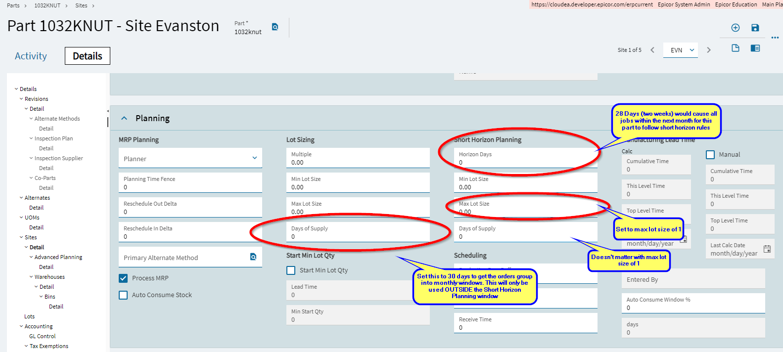

So… this is exactly how the “Short Horizon Planning” window can be used… within the short horizon, you can have different planning rules, than outside the window… Example (screenshot of Kinetic screen below) you can have a 28 day (4 week) short horizon window… every job within this window is planned using these parameters. but outside the 28 days, you can follow new rules, including the Days of Supply to group things into different buckets.
Cool. This is very thorough.
I made a rule eons ago that all trucks are max lot size of 1, so I would obviously need to set that to zero and allow the short horizon lot size to be where I set it to 1.

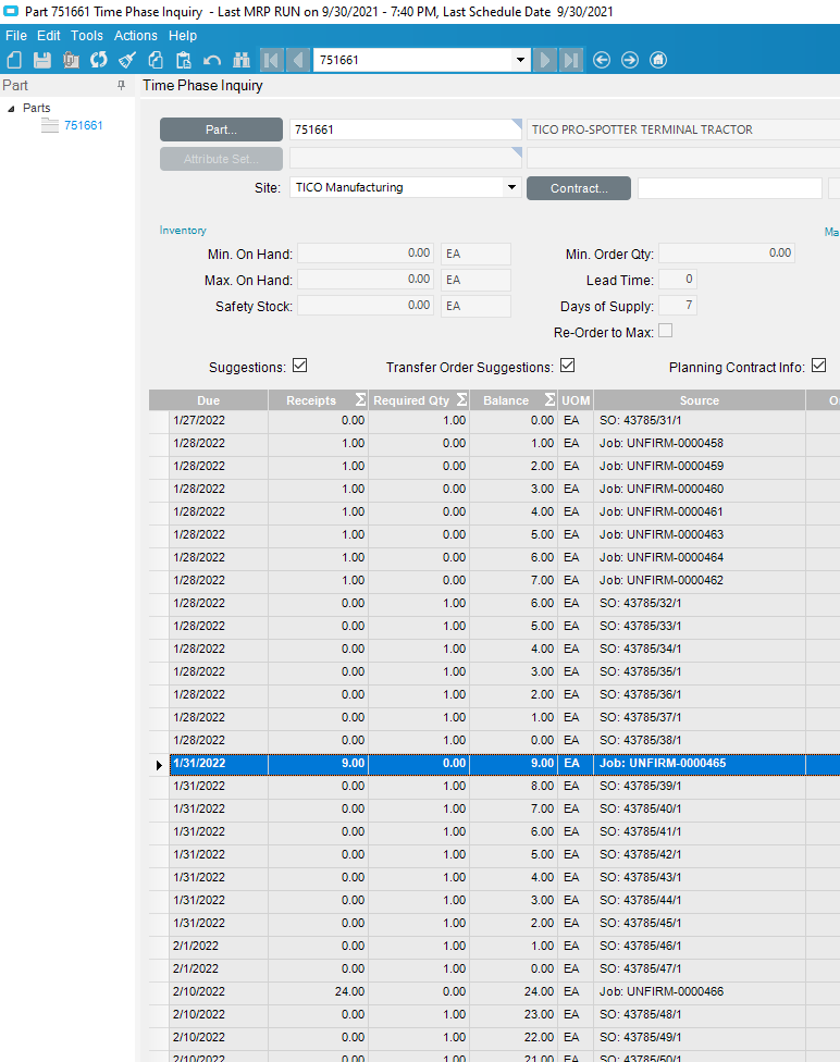

@timshuwy I did finally test this. The only way I saw it could work is to make the order lines NOT Make Direct. So I did that and there you have it in the pic below. For my test, I used 120 day “short” horizon and 7 days of supply, and it works well.
I’m just disappointed that it can’t batch the make direct lines into multiple demand links on a single job. But I see in the logs it processes “non-stock” demand first (one by one), then stock demand is batched.
