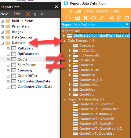

Unfortunately with a RDD based report this doesn’t happen. I completely see what you’re talking about when building with a BAQ based report. When you work from an RDD it rolls many of the fields up into a summarized dataset and drops the table identifier. Sometimes, if you’re lucky, it will include the original table in the format (table_datafield). I cannot find the mapping for that roll-up anywhere. It’s either in the code, on the server where I don’t have access (cloud), or some black magic that Epicor has cast. I’m convinced of the latter.
You probably tried using the “Sync Dataset” button on Report Style Maint.
This is almost always a very idea. (there are even threads her on how people hide that button to keep from accidentily clicking it).
Doing this will TOTALLY reconstruct your dataset, changing it from a single main table (with support tables like RptLabels, RptParams, etc…) to individual tables for each table (or view) from the RDD. It is also supposed to redo the queries to add any new tables and fields to the dataset.

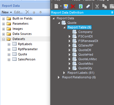

Normally your report dataset and RDD tables won’t look the same. Not sure what sync dataset is but that report doesn’t look right. Usually most fields are contained within the quote dataset on the report even if they aren’t from the quote table and looking that dataset’s query will show where fields are coming from.
Here’s what my working custom quote form report looks like.

I’ve always thought of RDD’s as being like a BAQ, but where all the displayed columns appear in just one “table”.
In your example, The QuotForm RDD references 9 DB tables (some might actually be views, like QuoteLnMsc). But when it runs, it puts the resulting data into one “table” named Quote, and adds the support “tables” (RptLabels, RptParamster, etc…)
