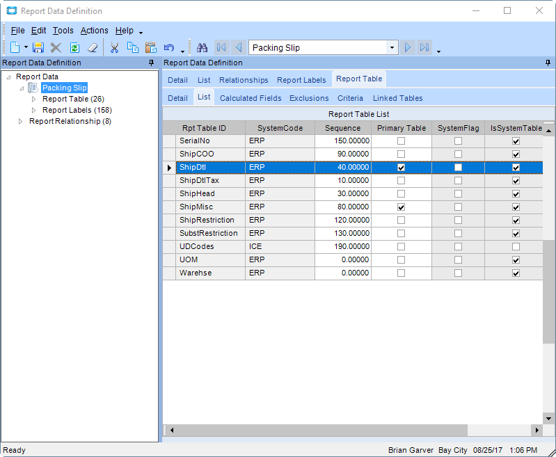

  1. Launch Report Data Definition, and load RDD “PackSlip”
  2. Use Actions\Duplicate Report, naming the new one “PackSlip_copy”

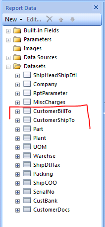

  8. Back in SQL Server Report builder, examine the Datasets for PackSlip_copy. The Datasets consists of 4 “tables”

  1. Open RDL PackSlip_copy with SQL Server Report Builder, and examine the dataset. You’ll see a much different structure now. Everything below the red line is new.

The PackSlip RDD has 25 tables, and 7 Relationships. (one of the tables is OrderHed)
The PackSlip RDL dataset shows 4 tables (ShipHeadShipDtl, Company, RptParameter, and MiscCharges).

The PackSlip RDD already includes the table OrderHed (although it appears to have no table relationships). And the OrderNum was already in the Picked Links. So I all have to do in the RDD is make sure the fields are in the Description Fields.

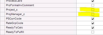

Since the OrderHed table was already included and the linked to the ShipDtl, why can’t I just make sure the OrderHed fields I want are not marked as Excluded?
Or am I misinterpreting what the Report Table Exclusion list means?
You are correct. Unmark the Excluded checkbox for any additional field you want, add the field to the Select statement in the Query and add to the Field List in the RDL.
