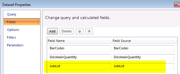

I edited the RptParameter Query, adding “,T1.JobList” to get:
="SELECT T1.BarCodes,T1.DecimalsQuantity,T1.JobList FROM RptParameter_" + Parameters!TableGuid.Value + " T1"
and added the new field
That worked.

  2. In my example above, I manually edited the RDL dataset query and fields, adding field “JobList” to the RptParameters “table”. That was a lucky guess based on what fields were available in the dataset in a CR. Looking at an RDD’s innards, doesn’t give any hints at what would be available in the tables like “RptParameter”
