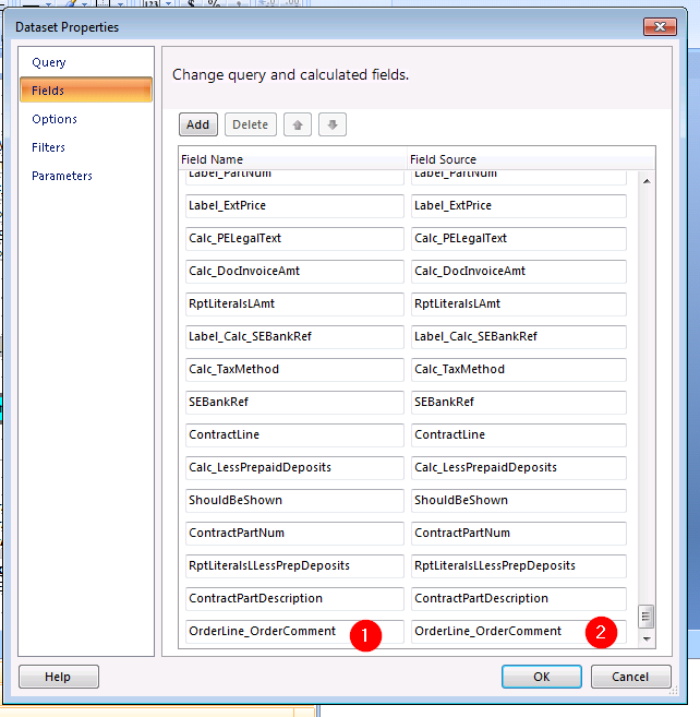

Just curious … can you change the field name in the Fields tab of the dataset properties?
Does (2) below need to match the query expression, while (1) is what shows in the report builder?
Such that I could change (1) to OrderComment?
Number 1 can be anything you want. Number 2 has to match what you have it as in the dataset.
If you look at my previous post that has the tip in it, you will notice you can give the field an alias that you reference instead. If you do that, then both fields can be OrderComment instead of number 1 being: OrderComment and number 2 being: OrderLine_OrderComment
For what you are doing, either way works fine.
When you start creating complicated fields though, the alias is a must.
My example being, I have a long expression in the select statement that modifies the AddressList to something I like better. No way to put all of that in the field source so you give it a short alias like AddressList02 and that is what you reference.
Hope that makes sense to you.
