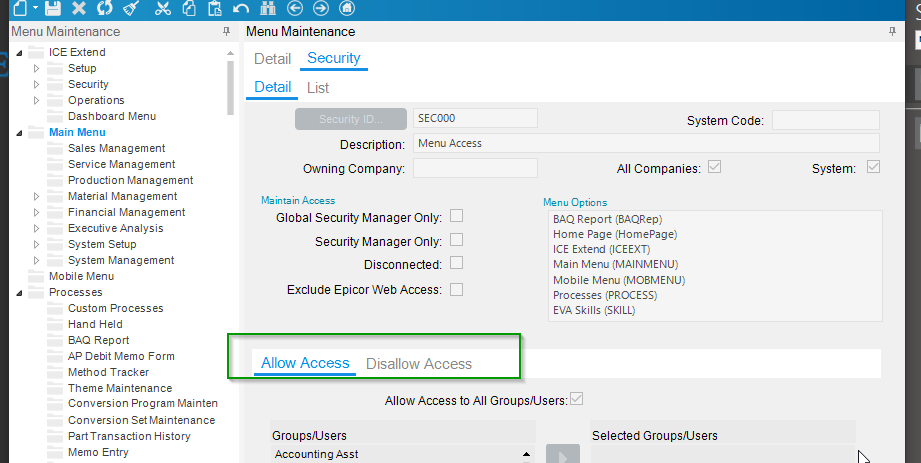

Hi - for Epicor 10 and Menu/User Maintenance, is there a way to grant read-only access to users for certain pages or fields?
It seems like the only options are to allow access or disallow access.
There’s a “Read Only” checkbox for menu items in menu maintenance (on the detail tab). So you could have multiple menu items to achieve what you’re after.
