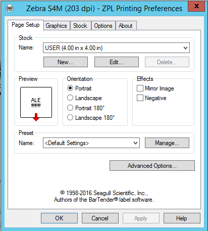

When I want to print something else than a BarTender file I typically have to configure these settings on the Printer for it to work.
Basically:
  • Select the USER preference
  • Click Edit and set 4x6
  • Make sure you are doing this by going to “Devices and Printers”
  • Also sometimes you also have to do it in the Select Printer Dialog before Printing
  • Once its set, it works and sometimes resets when you update the Zebra Drivers.
