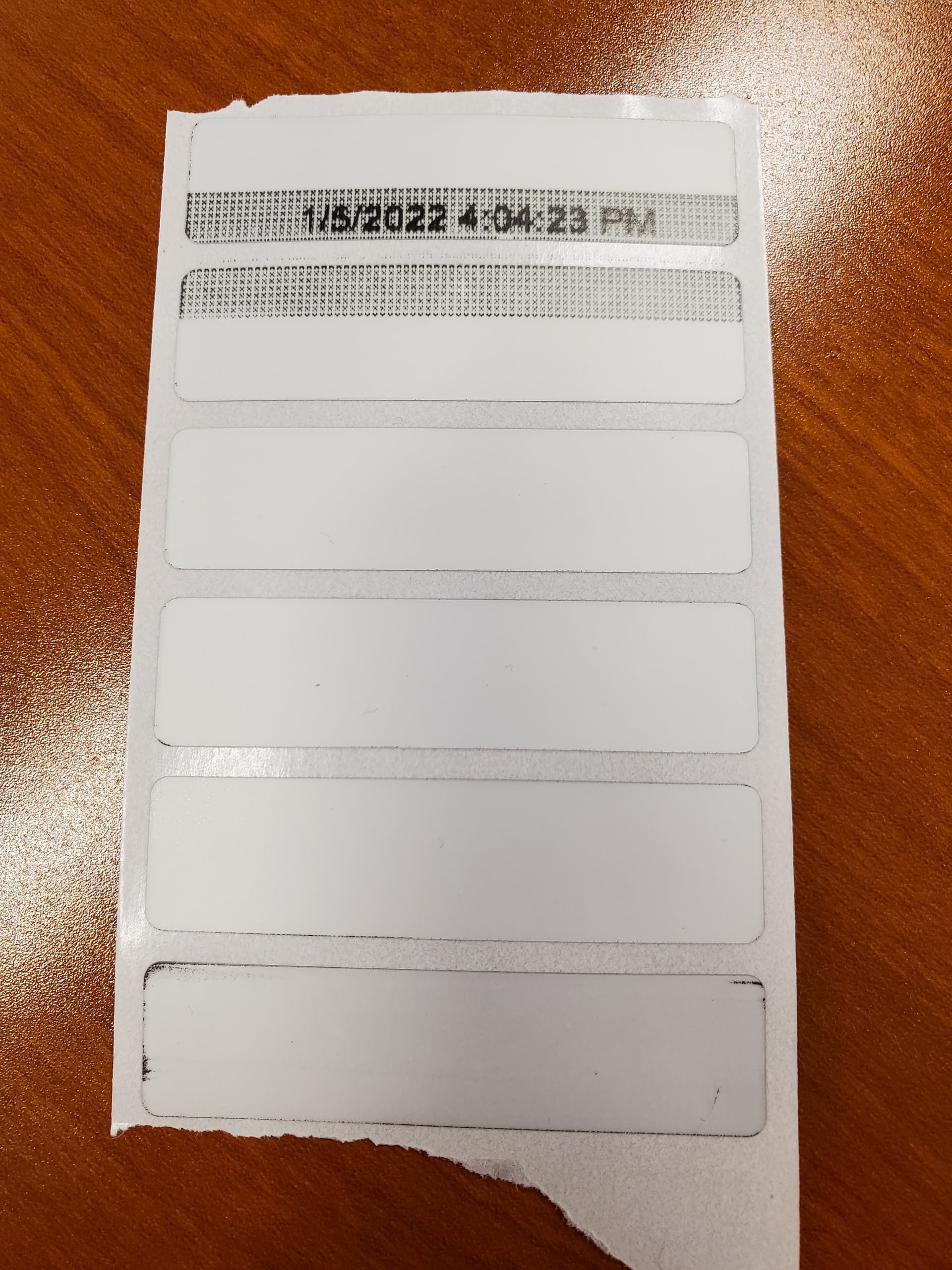

I’m trying to print a BAQ report as a 2" x 0.5" inch label but keep having an issue where the label printer sends out four blank labels and then the report split between the fifth and sixth labels.
I’ve tried changing the size and orientation in the client print settings to no avail. I can print to pdf and print to the label printer from there and I get a perfectly centered, single label every time so I’m not sure why printing through epicor is causing these issues.
I reformatted the material tag that users print at the time of receipt. Yes I encountered some issues I am sure of it. Yes by just dotting i’s and crossing t’s, making sure the report definition is setup right-sized and the label printer preferences are setup with label stocks and proper defaults, things like that, I was pretty sure I was able to get it to work.
