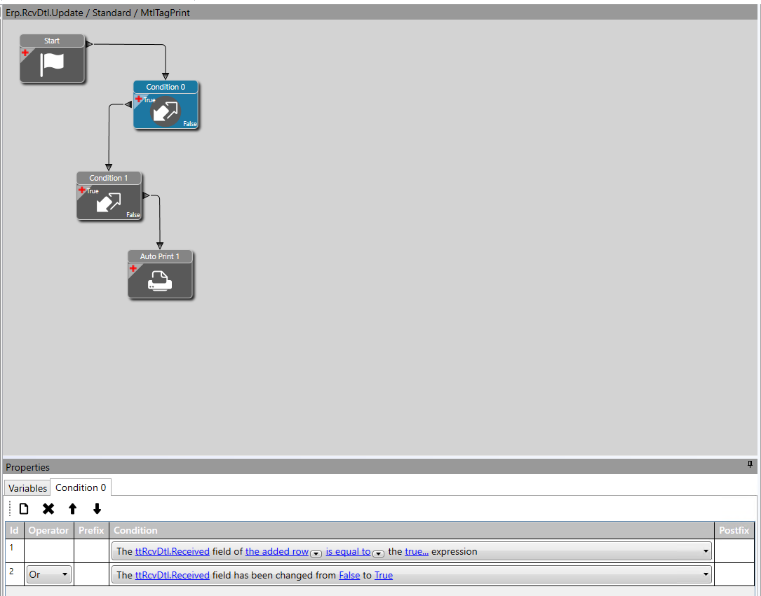

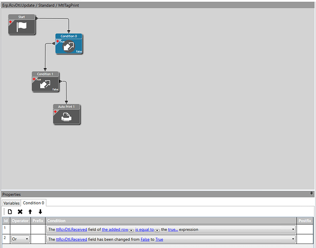

You would need to send us some screenshots of your Data Directive that Prints Labels. It could be that your Condition is missing, or it could be that the RDD it uses is duplicating it.

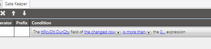

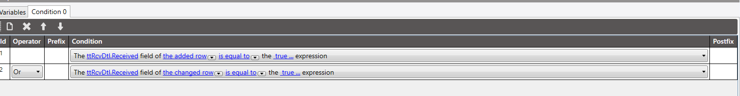

I assume you have your BPM on RcvDtl where it should be and a Condition to make sure you Print only the Qtys they commited or checking to make sure you only do it on the “Changed Row”.
Auto-Print something like
With Rule
If that all checks out, you need to check on your Commander/Integrations BarTender side if its set to duplicate or if the .btw file itself is duplicating it.
AutoPrintSettings
Rule
Have you tried a third condition of to verify the RcvDtl.PackSlip mateches?
And add parenthesis like : (1 OR 2) AND 3

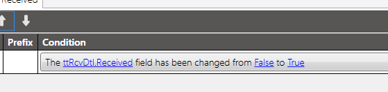

You might need to use this condition.
I use OurQty because we want a Label per Commitment, so you could Partially receive, and you will always get a label for the Qty added to Inventory (rcvd).

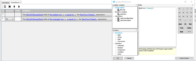

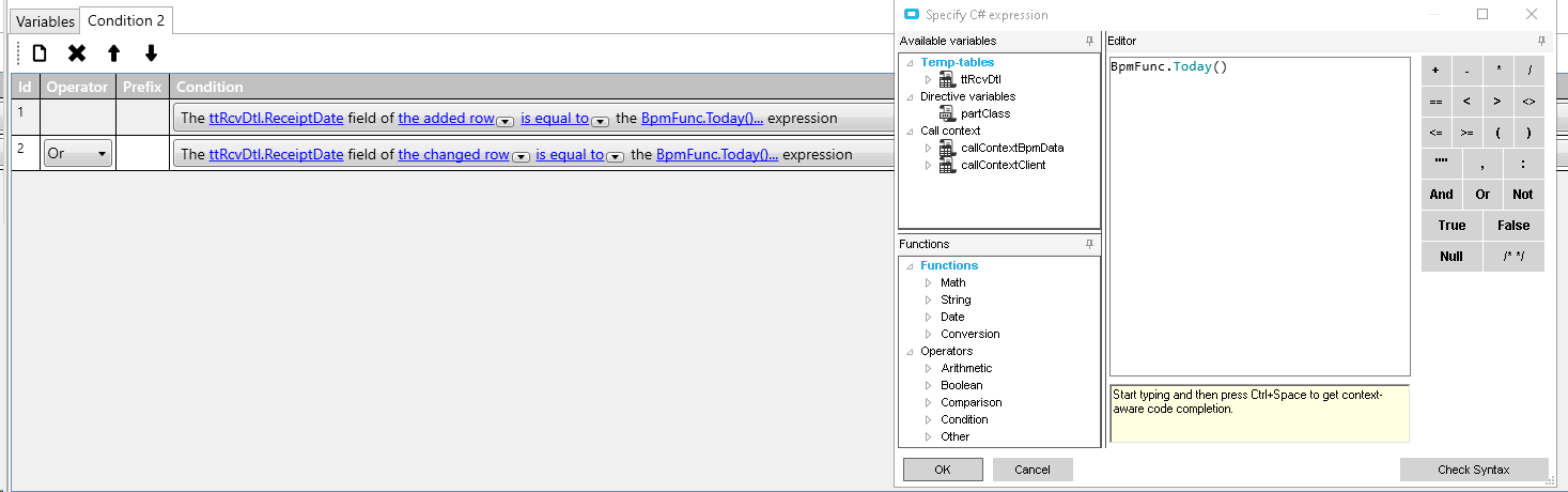

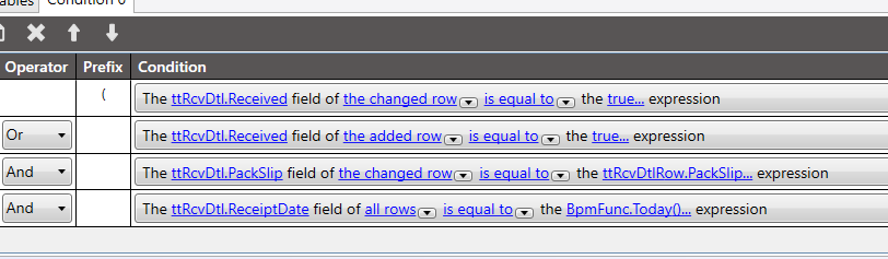

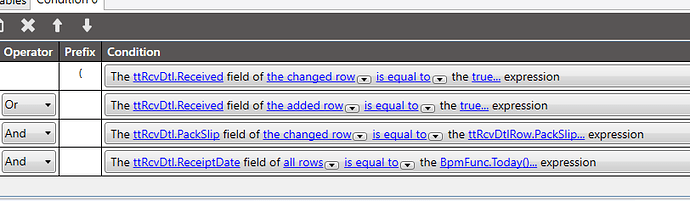

I added another condition to prevent printing labels with a receipt date older than today.
I have added a condition to check the date and make sure the receipt is today, The picture below shows how we are doing this and the only issue I have heard of is that it is still printing labels from a receipt from the day before. Am I using this correctly or is today include the last 24 hours.
these are my conditions on this BPM
