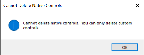

First issue is I can’t delete controls:
So I have tried to hide them. I have been successful in hiding all controls but the EpiTreeViewPanel.
