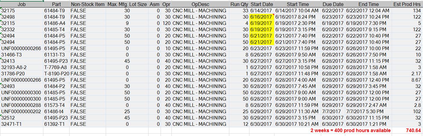

Resource Scheduling Board scheduling jobs that use the same resource group on top of each other. Why?
We are trying to figure out why our system is scheduling jobs on the same resource group (which only has “one” resource in it) on top of each other (See pic below). We only have 200 possible running hours per week that this machine can run but it is scheduling over 400. Can anyone give me an idea what could cause this behaviour?

Brad, scheduling blocks are 1 and the Finite box on the resource was NOT set to finite capacity. I hope that’s the magic bullet. I’ll check it again after MRP runs tonight. Thanks for the heads-up.
