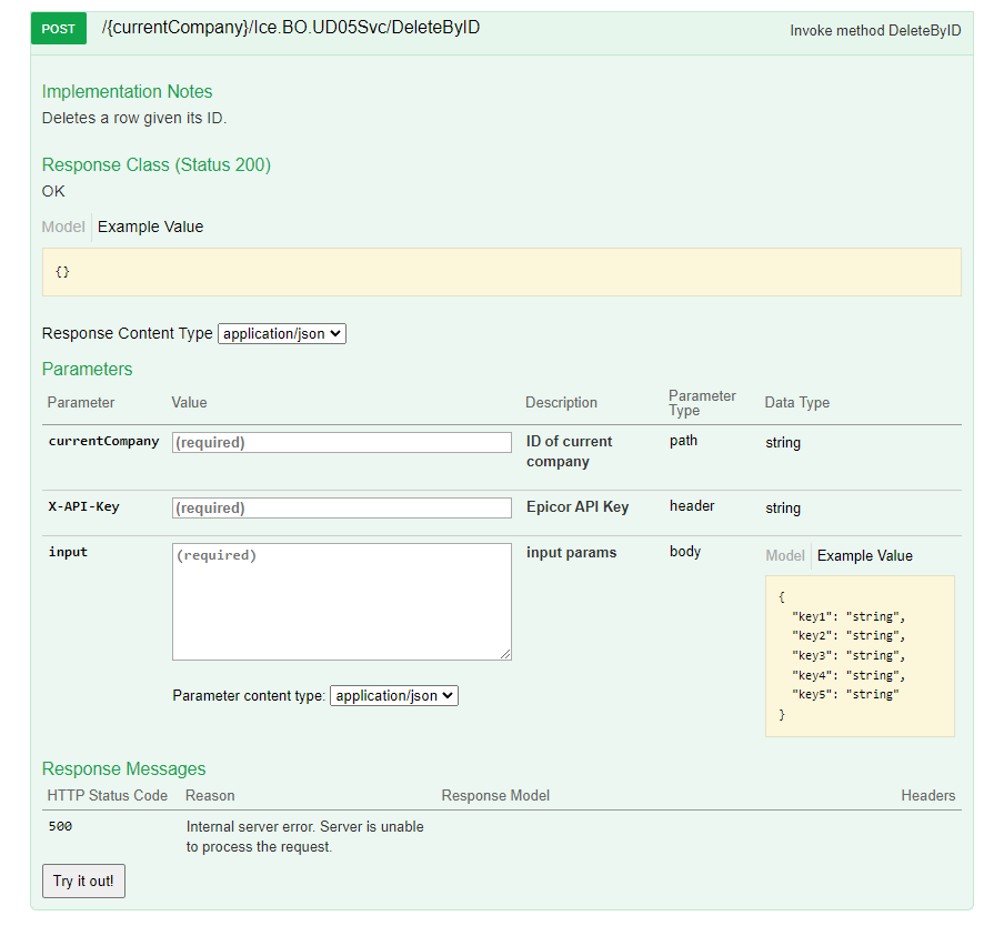

The % in the URI is going to be the problem and because of the way that’s passed through I don’t believe any amount of encoding will fix that. I would switch to using the custom method for this over the oData method. In that case you’ll be posting a quoted body string vs putting in the URI
Hi Joshua,
Just to follow up on this topic. The Custom method solved my issue.
