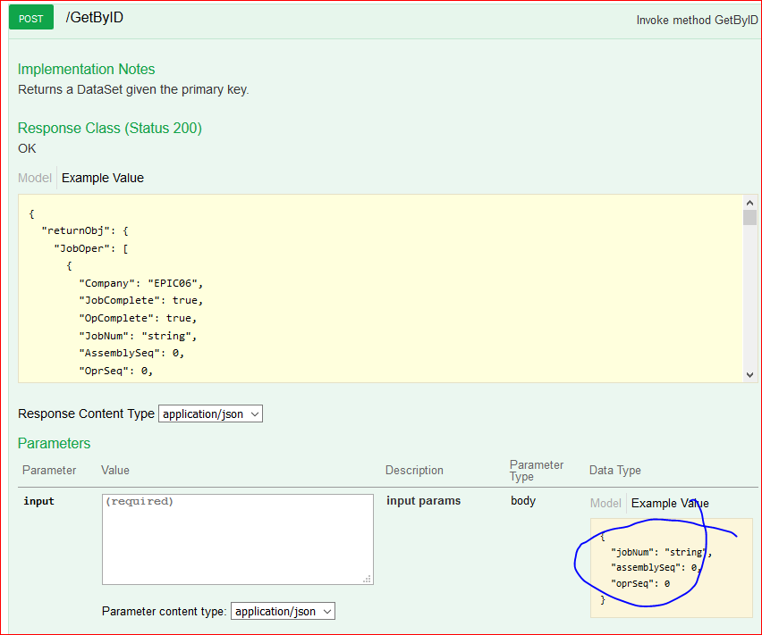

I had a chance to glance at your example. The pattern is the same in many areas. The OData wrappers take some assumptions based upon the BO services that are ‘full’ BOs with the classic core methods. The OData method you mentioned maps to GetByID on cor emethods as indicated in the swagger page:
When you look at GetByID, it has the following API surface:
public JobOperSearchTableset GetByID(string jobNum, int assemblySeq, int oprSeq)
And all GetByID core methods have a similar pattern:
parameters.Add(“Company”, CallContext.Session.CompanyID);
parameters.Add(“JobNum”, jobNum);
parameters.Add(“AssemblySeq”, assemblySeq);
parameters.Add(“OprSeq”, oprSeq);
InnerGetByID(Db, 0, 0, out morePages, CurrentFullTableset, parameters);
So this is the oddity in ease of use that you stumble into when you look at the keys to the table versus the method signature:
Company handling is an interesting ease of use question we are investigating. Some methods take company, some don’t so the underlying methods being inconsistent caused the OData Wrapper to rely upon the key of the tables. There are some options and investigations on what’s the best approach.
