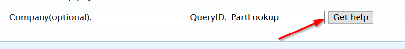

Does the rest help functions not work in firefox? When I click on this button in firefox, nothing happens. If I do in chrome I get the help info to pop up. Or do you think it’s something to do with my personal settings?
it looks like a bug in Get help button submitBaqForm function.

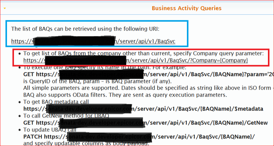

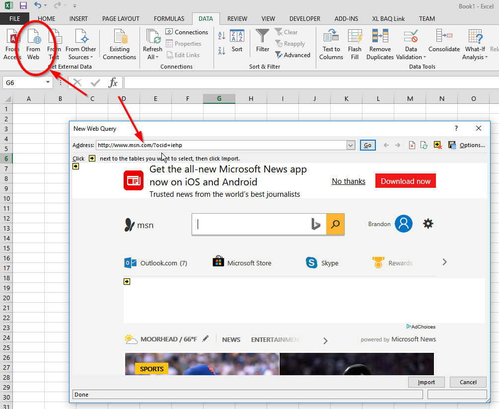

If you take that address from the swagger page, and use that to in the from web section in excel, it will walk you through loading a file that will list all of the BAQ’s. It looks like you can refresh that list too. It’s not Odata, it’s XML, but if I could figure it out, it must not be too hard. Not knowing your end goal, I don’t know if this does what you want or not, but it’s possible to get a list in excel.
