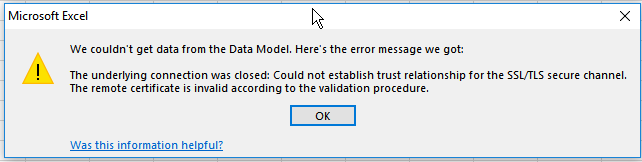

I’m having some problems with the certificate. I can get a query to run in the web browser, but when I try to bring in the address to excel to use the Odata import, I get this error. Any idea what we are missing?
Excel requires a higher level of trust than getting a warning in a browser and ‘proceeding unsafely’. If your self signed cert does not get stored in the correct place in the certificate store, Excel complains. There is no Excel version of ‘ignore warning and proceed unsafely’ that I am aware of.
When I first try it in a new excel sheet, I get this warning. I can view the certificate and install it (using the defaults that it provides), but that doesn’t seem to to anything different. Is there something that needs to be done to the SSL itself to allow this?

Yeah that was a deal breaker for us, we ended up coding around it with a VSTO plug in for @jgiese.wci (we demoed it a bit at insights earlier this year). Excel is super zealous with security (for a good reason)
There is no known way around it other than having a legit cert that excel trusts. If you are in a domain you could try and push it via GPO and an internal CA , or install the internal self signed cert on each work station but that was also a pain point we couldn’t always get past.
