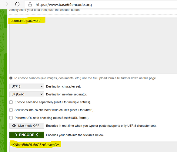

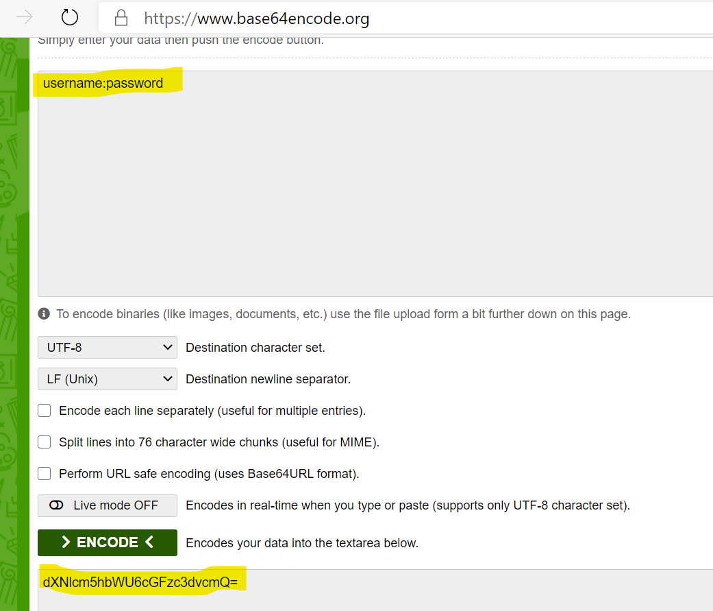

Trying to troubleshoot this in PostMan to see if I can get it to go through there. What do we enter for the key, {username}:{password} in base64?
You concatenate the username + ‘:’ + password then base64 encode it. See example here for the idea. .Net has the encoder as well.
@Mark_Wonsil,
I was adding in the {} on either side of the concatenation, my bad. Also, does the key have to have a type associated with it, or do I just add it to the back of the request URL?

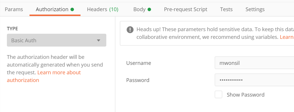

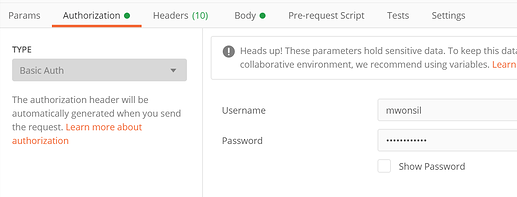

In Postman, it does it for you in the Authorization Tab:
In your code, it goes in the Authorization line of the http headers:
