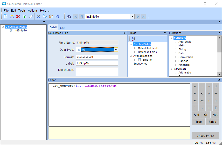

Use a calculated field…
try_convert(int, ShipToNum)
Then filter BAQ for calculated field > 0
@bmgarver I tried similar earlier, just without the filter. I get this error. Conversion failed when converting the nvarchar value ‘(nw)04066’ to data type int.
you are using try_convert and not convert, correct? try_convert should not give an error if it fails, just return an empty value.
My mistake I though you said to try! LOL! I used it and it worked. Thanks!
