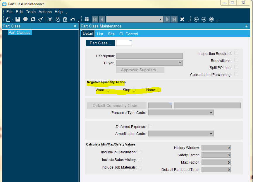

So it sounds like what is happening is that Epicor is letting you go negative in one Bin and the net is still positive. There is a setting in Part Class that should prevent this from happening. You can stop, warn or do nothing. I believe the default is to do nothing. You may want to look at this.

We had that set to stop and it still allowed our bins to go negative as long as the overall sum in the warehouse was positive.
Then a BPM is probably going to be required to prevent this. Always something!!
