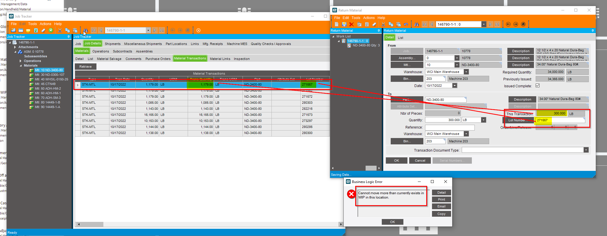

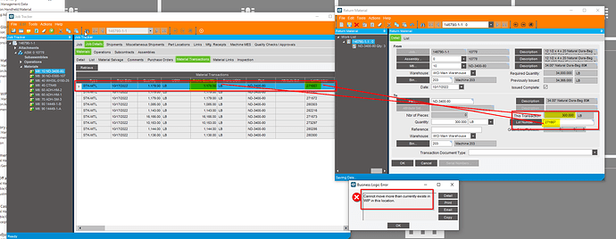

Has anyone noticed that after latest upgrade you can not return material to stock from job if run qty meets completed qty. It now says that there are no qty on wip. Usuly we have been returning paint powder when we had powder savings during part grouping on painting line.

Response from Epicor - Ok, this is what is happening, in 2022.2.3 a new feature was added called WIP PCID, and this feature affects the also regular WIP, this is happening because you completed the operation linked to the material, so that material is no longer available, it has been consumed, so there is nothing else left to return
As an example, you are doing Jellow, and it is done, but then you want to take the water out if, you cannot do it anymore, so it is the same logic here
The only option is to delete the labor record to have that material unconsumed, do the return quantity and the enter the labor quantity based on the material you have.
