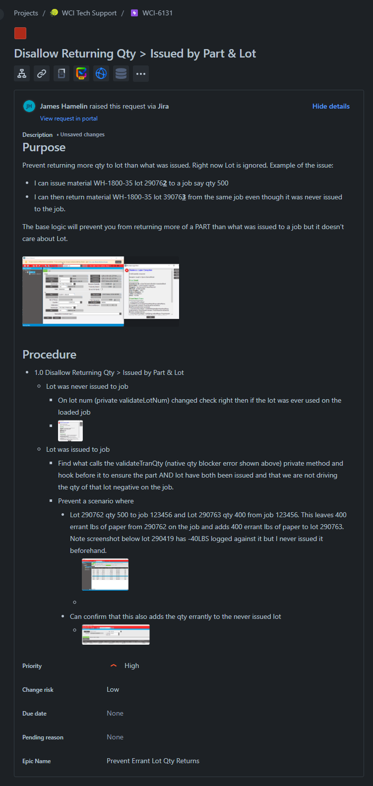

We have an internal ticket in our system to control that. It will be a BPM. This is how I rough speced it

Here is the one I just built. Go ahead and test it out if you like see if it does what you need it to. Might have to load it in an upgraded staging database then grab the code out of it.
WCI-6131.zip (26.8 KB)

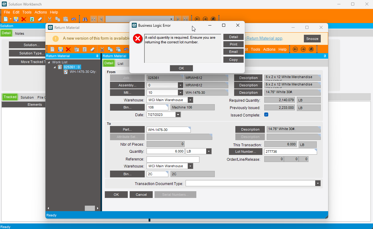

It has a bug lol. I forgot to handle null results if no transactions were made at all.
WCI-6131.zip (27.1 KB)
Final working version with error for a lot that was never transacted on the job (null)
