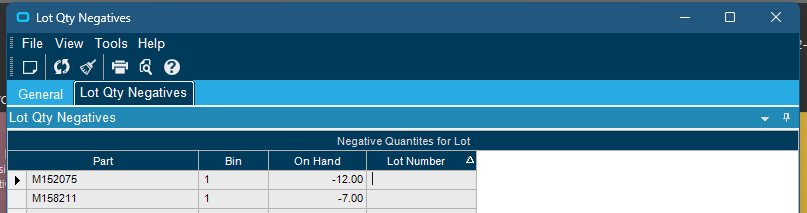

Quick check on our Lot Qty Negatives Dashboard and those fields are blank, no space nothing…

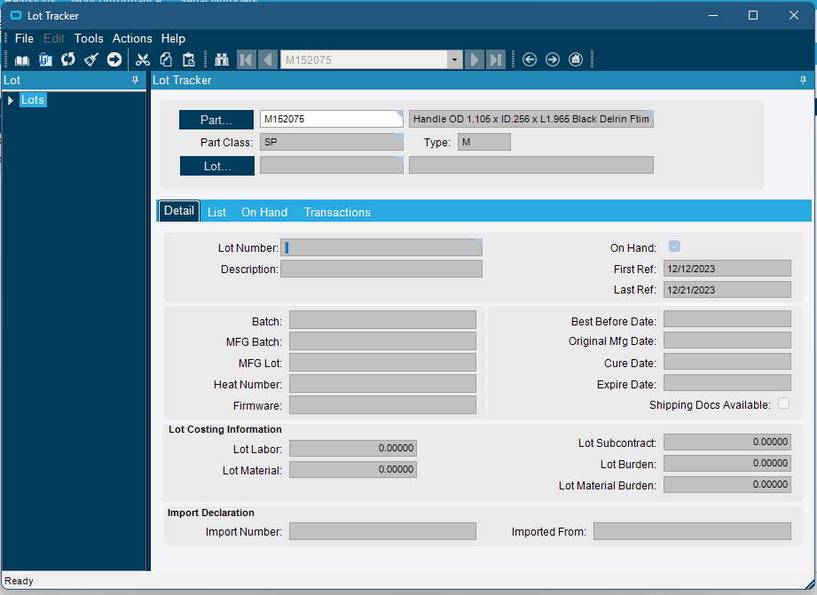

However when in Lot Tracker if you select that lot number you can then highlight that field that makes it look like there is a space… I need to do more testing.

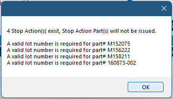

Ok, I’m not totally crazy… you can’t create lot numbers from the Mass Issue screen… I just tried doing a Mass Issue on the problem job in our training DB with all the same lot numbers that were used before but this time entering just a space in the fields that I wanted it to create this phantom blank lot number and I got this error, which is what I would expect to see. So unfortunately this instance of a blank lot number being created goes unsolved. I hate it when stuff like this happens.

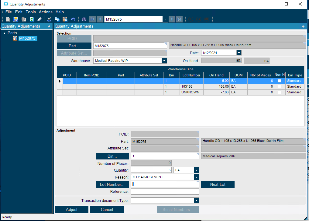

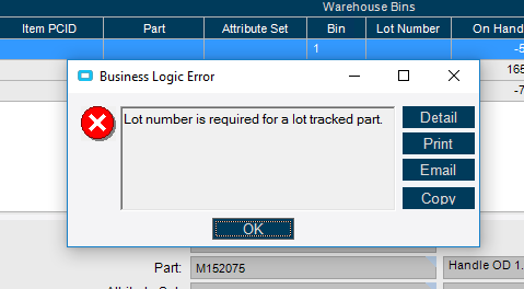

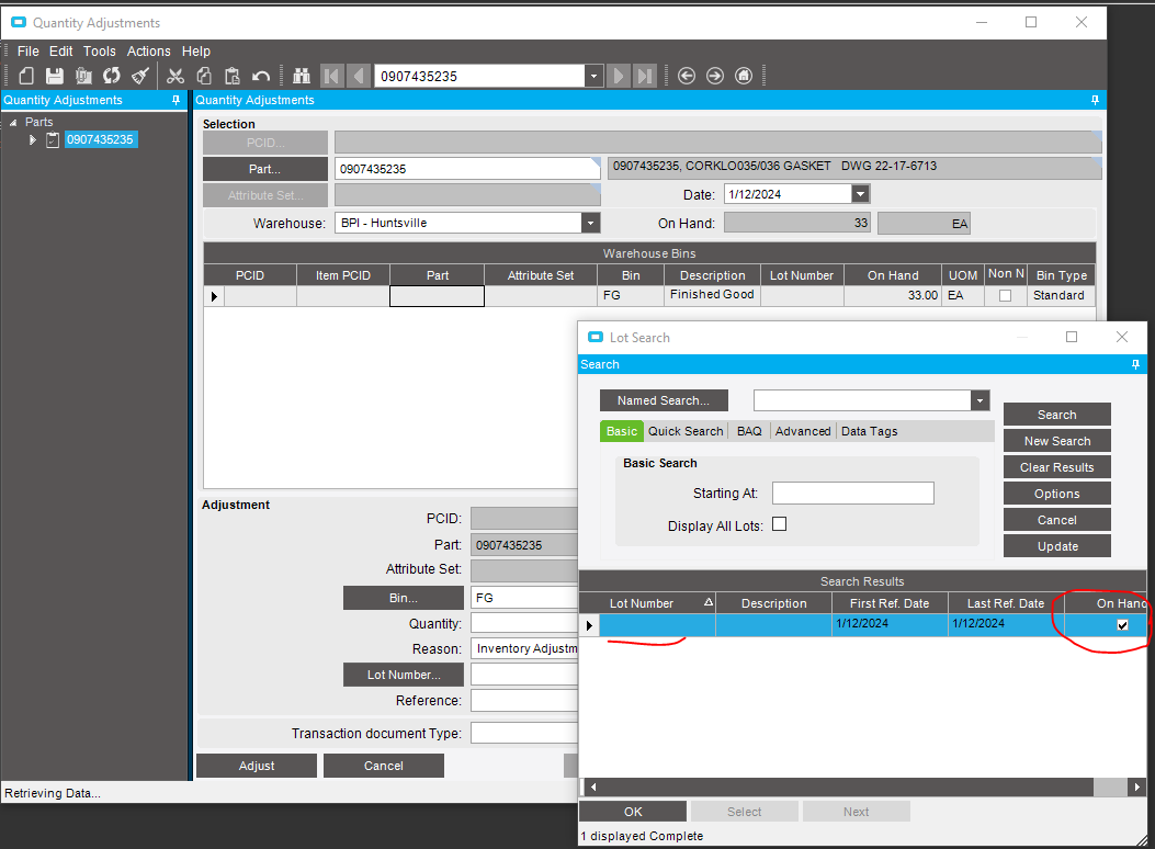

Adam, I’m not able to create a lot number that is just a space… it does not recognize that as a valid lot number. You can see here I’m trying to adjust that -5 out and I did a Lot search and selected the one that looks to be blank… and when selected if you highlight the lot field it shows a space… however it error’s out when you click on adjust.
Yes, the quantity adjustment module will still throw an error for that lot number. But it is still created, and after it’s created I was able to see it on the “lot search”, and then I was able to select it on the “Issue Material” module (where it doesn’t error like qty adjustment module).

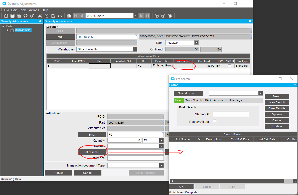

Here is what I was running into before I created the " " lot:
The empty lot qty in inventory was not appearing on my lot search until I created the " " lot. After creating the (invalid) " " lot, that blank lot qty gets linked to it and I am able to select it in the lot search:

Well the initial transaction was re-tagged as Unknown after running the refresh partbin QOH from PartTran as you suggested. However the transactions that were performed after that blank lot was created, using material issue, were not re-tagged as anything so they still showed up as blank, or space.
