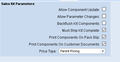

I’m going to try something… But first, what are the Parameters for the Sales kit parent:
Hi again Calvin :slight_smile:
Here are the sales kit parameters: https://i.imgur.com/hhaiynC.png (how do I embed an image like you?)
Now that I see the option, I recall seeing something about using Component Pricing instead of Parent Pricing, but for some reason or another that I don’t recall, that was not a suitable option for us. I’ll try to find out why that was.

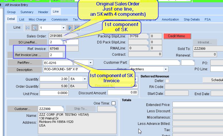

The invoice creates the hidden lines for the SK components too.
Are you just creating a Credit Memo and manually adding lines? If so, you can reference those hidden invoice lines instead of the parent line:
Just ran into this. Did something similar to what Calvin recommended, but changed the SO Line on the Misc Detail to the Kit Parent Line to pull in the correct part #, price etc for the credit. In the example above, changed SO Line to 1.
