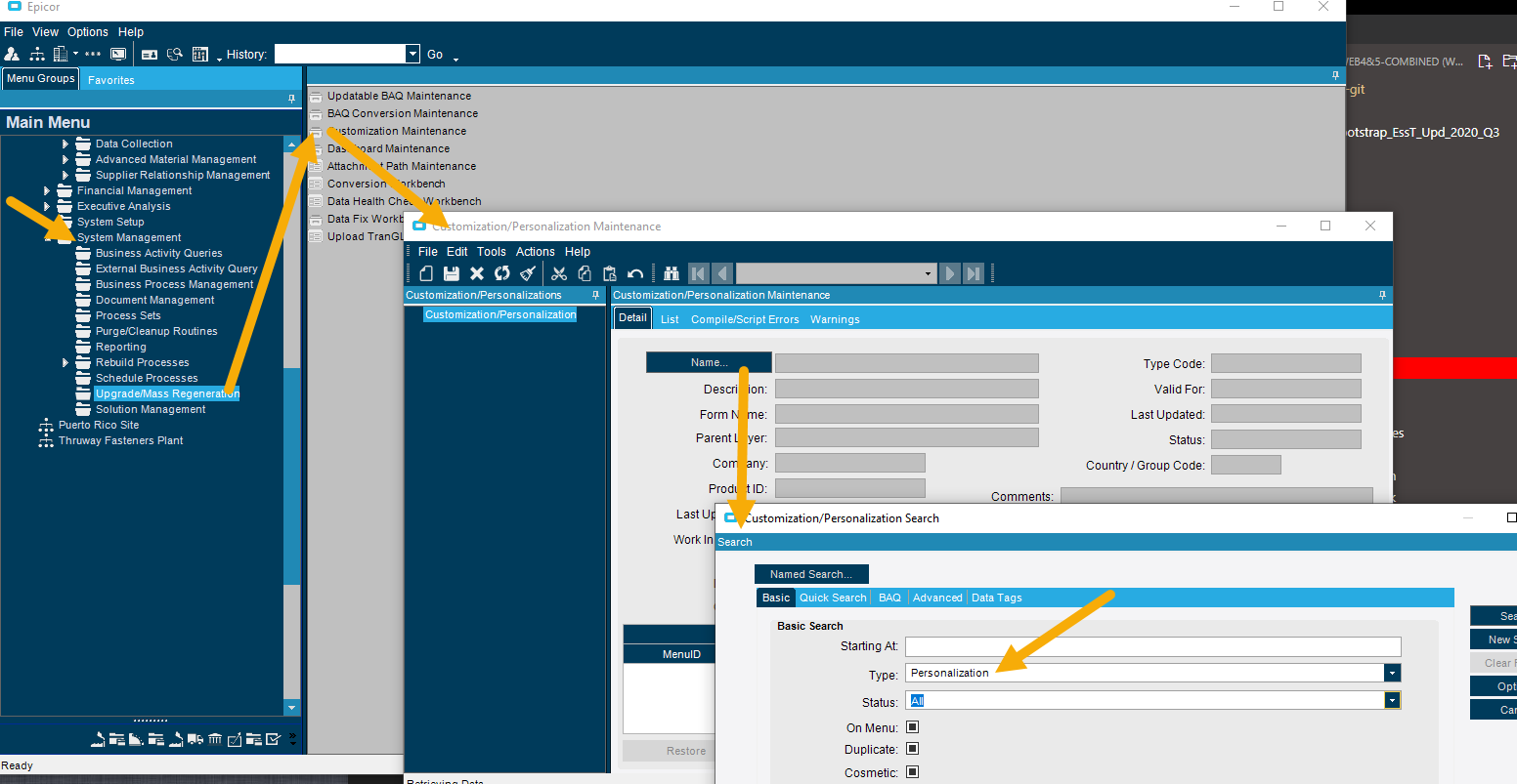

Maybe try clearing out that user’s personalizations?
Other than that I wouldn’t know why Publish and Subscribe would break.
